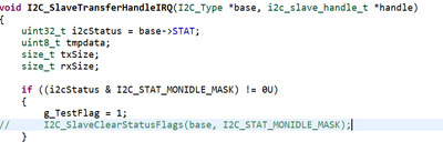

在lpc55S69的iic通信中,fsl_iic.c的库文件中有kI2C_SlaveIrqFlags | I2C_INTSTAT_MONIDLE_MASK就能判断一帧数据是否发送或接收完成?实际测试过程中,图二中的这个标志位没有置位?请问这个I2C_INTSTAT_MONIDLE_MASK这个功能该如何使用呢?

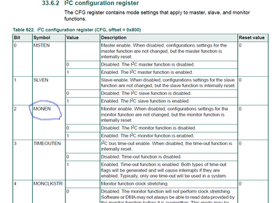

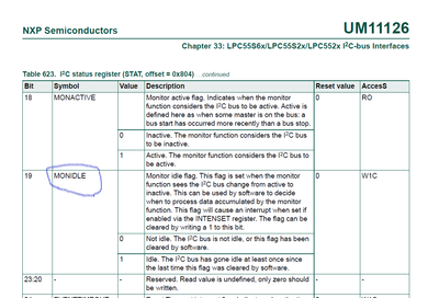

Regarding the bit of I2C_INTSTAT_MONIDLE_MASK bit, pls refer to the I2C status register as the following pic, I copied from UM11126.pdf(UM for LPC556x/2x).
If you want to use the monitoring function, you have to enable monitoring function in CFG register.
You can use the code to set the MONEN bit:
I2C0->CFG|=1<<2;
