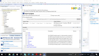

In the SDK package for LPC55S69, there is CASPER examples, which includes the RSA example and ECC examples. I copy the screenshot for loading the casper examples in SDK package. there is 256 bits and 384 bits ECC examples.

/* Begin code to test elliptic curve scalar multiplication. */
int i;
int m1, m2;
int errors = 0;
for (i = 0; i < 8; i++)
PRINTF("Round: %d\r\n", i);
uint32_t X1[8], Y1[8];
uint32_t *X3 = &test_ecmulans[i][0];
uint32_t *Y3 = &test_ecmulans[i][8];
CASPER_ECC_SECP256R1_Mul(CASPER, X1, Y1, &test_ecmulans[0][0], &test_ecmulans[0][8], test_ecmulscalar[i]);
CASPER_ECC_equal(&m1, X1, X3);
CASPER_ECC_equal(&m2, Y1, Y3);
if (m1 != 0 || m2 != 0)
errors++;
if (errors != 0)
PRINTF("Not all EC scalar multipication tests were succesfull.\r\n");
PRINTF("%d / 8 tests failed.\n", errors);
else
PRINTF("All EC scalar multiplication tests were succesfull.\r\n");
/* End code to test elliptic curve scalar multiplication. */
