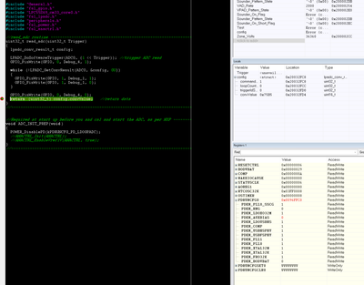

Hello, I have used the config tool to setup LPC55S69 ADC channel but the result is always 32768 (or half of the 16 bit total value) I have moved the voltage on the pin between 0 - 3.3V but the result is always the same. Included below is a scope trace showing the time to run the autocal (green) and then sampling (Pink), the yellow trace is the ADV input voltage around 2V. Also the code used to obtain the measurements.
uint32_t read_adc()
lpadc_conv_result_t config;
GPIO_PinWrite(GPIO, 1, Debug_1, 1);
LPADC_DoAutoCalibration(ADC0);
LPADC_DoSoftwareTrigger(ADC0, 2); //trigger ADC read
GPIO_PinWrite(GPIO, 1, Debug_1, 0);
GPIO_PinWrite(GPIO, 0, Debug_4, 1);
while (!LPADC_GetConvResult(ADC0, &config, 0U)){}; //wait for result
GPIO_PinWrite(GPIO, 0, Debug_4, 0);
return (uint32_t) config.convValue; //return data

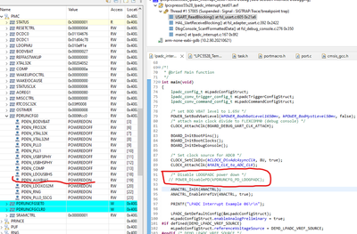

All I can tell you is, I comment that line out and PDEN_AUXBIAS is set to 1 but the ADC is still running, I have the local watch and scope with debug to confirm.
The other way around sets AUXBIAS to 0 as expected.
I stand by the comment, I made a few days ago, it is like there is another location in the ANACTRL register that enables the 1V reference as well.

Did you reset / power off your board after flashing the code? I'm asking the usual code-compile-flash-debug-procedure does not reset the peripherals (at least not on my board).
I ran into this issue while testing whether the call  POWER_DisablePD(kPDRUNCFG_PD_LDOGPADC); is required. First I ran code that included this call. Then I commented out this call, compiled, flashed and ran the changed code. Still, AUXBIAS in register PDRUNCFG0 was powered on (== 0x0). See this screenshot:
Only after I pressed the reset button on my board, the AUXBIAS returned to reset defaults (== 0x1 == not powered). Then I saw the "half rail" ADC values again.

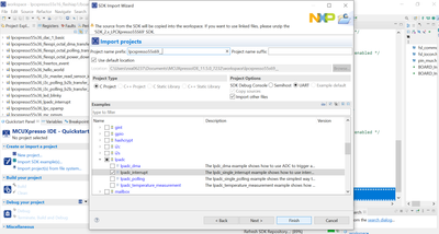

Thanks, @xiangjun_rong .
Your findings correspond with the code provided in this article.
However, the example "lpadc_interrupt" (from drivers section of LPC5528 SDK) does use all three calls.
I wonder why this is?

Hi @sanders7284 ,
I'm coming back to this issue as it just hit me, too, and your solution got the ADC working. Thanks for sharing.
I figured that the call to
is sufficient to get the ADC working. It seems to me that output of 1V reference voltage does not need to be enabled in register AUX_BIAS. Can you confirm this?
Note, the API call POWER_DisablePD() manipulates the PDRUNCFG0 register which controls the power to various analog blocks. Here, bit 19 (aka PDEN_AUXBIAS) is cleared. Contrary to what the name insinuates, this call powers up the peripheral.
I wonder whether this call should be issued before the ADC is being initialized or calibrated. At least it also works if I issue it after initialization and calibration and just before triggering the first conversion.

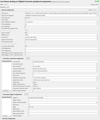

Thank you for the reply, the channel setup code is auto generated from the config tools as below:-
* ADC0 initialization code
/* clang-format off */
/* TEXT BELOW IS USED AS SETTING FOR TOOLS *************************************
instance:
- name: 'ADC0'
- type: 'lpadc'
- mode: 'LPADC'
- custom_name_enabled: 'false'
- type_id: 'lpadc_ddcc12878b96237847ab78b571214e1c'
- functional_group: 'BOARD_InitPeripherals'
- peripheral: 'ADC0'
- config_sets:
- fsl_lpadc:
- lpadcConfig:
- clockSource: 'AsynchronousFunctionClock'
- clockSourceFreq: 'BOARD_BootClockRUN'
- enableInDozeMode: 'true'
- conversionAverageMode: 'kLPADC_ConversionAverage16'
- offsetCalibration: 'yes'
- autoCalibrate: 'true'
- enableAnalogPreliminary: 'true'
- powerUpDelay: '0x80'
- referenceVoltageSource: 'kLPADC_ReferenceVoltageAlt2'
- powerLevelMode: 'kLPADC_PowerLevelAlt4'
- triggerPriorityPolicy: 'kLPADC_TriggerPriorityPreemptSubsequently'
- enableConvPause: 'false'
- convPauseDelay: '0'
- FIFO0Watermark: '0'
- FIFO1Watermark: '0'
- FIFO0WatermarkDMA: 'false'
- FIFO1WatermarkDMA: 'false'
- lpadcConvCommandConfig:
- 0:
- user_commandId: 'Sounder_Monitoring'
- commandId: '7'
- chainedNextCommandNumber: '0'
- sampleChannelMode: 'kLPADC_SampleChannelSingleEndSideA'
- channelNumber: 'CH.4'
- enableAutoChannelIncrement: 'false'
- loopCount: '0'
- hardwareAverageMode: 'kLPADC_HardwareAverageCount16'
- sampleTimeMode: 'kLPADC_SampleTimeADCK3'
- conversionResoultuionMode: 'kLPADC_ConversionResolutionHigh'
- enableWaitTrigger: 'false'
- lpadcConvTriggerConfig:
- 0:
- user_triggerId: 'Sounder_Monitoring_Trigger'
- triggerId: '1'
- targetCommandId: '7'
- delayPower: '15'
- priority: 'false'
- channelAFIFOSelect: '0'
- channelBFIFOSelect: '0'
- enableHardwareTrigger: 'false'
- IRQ_cfg:
- interrupt_type: ''
- enable_irq: 'false'
- adc_interrupt:
- IRQn: 'ADC0_IRQn'
- enable_interrrupt: 'enabled'
- enable_priority: 'false'
- priority: '0'
- enable_custom_name: 'false'
* BE CAREFUL MODIFYING THIS COMMENT - IT IS YAML SETTINGS FOR TOOLS **********/
/* clang-format on */

xiangjun_rong
This is what you defined:
- triggerId: '1'
Based on above configuration, pls try to change your ADC code like:
uint32_t read_adc()
//LPADC_DoSoftwareTrigger(ADC0, 2); //trigger ADC read
LPADC_DoSoftwareTrigger(ADC0, Sounder_Monitoring_Trigger); //Rong wrote trigger ADC read
Pls have a try.
XiangJun Rong

sanders7284
Thanks I have tried this with a slight difference as there was no definition for sounder_monitoring_trigger.
Instead I was able to find:-
/* Trigger 1 - Sounder_Monitoring_Trigger */
#define ADC0_SOUNDER_MONITORING_TRIGGER 1U
Giving code like this.
uint32_t read_adc()
LPADC_DoSoftwareTrigger(ADC0, ADC0_SOUNDER_MONITORING_TRIGGER); //trigger ADC read
This now gets stuck in the while loop never gaining a result.

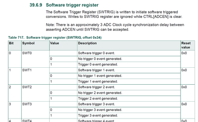

After looking at the user manual I believe the code I had originally with a value of 2U is correct, as the register is bitwise, so a 1U as now set up will trigger event 0, so now the wrong event.
The passed value is not shifted, it is used directly, as below.
* @brief Do software trigger to conversion command.
* @Param base LPADC peripheral base address.
* @Param triggerIdMask Mask value for software trigger indexes, which count from zero.
static inline void LPADC_DoSoftwareTrigger(ADC_Type *base, uint32_t triggerIdMask)
/* Writes to ADCx_SWTRIG register are ignored while ADCx_CTRL[ADCEN] is clear. */
base->SWTRIG = triggerIdMask;
