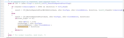

I can reproduce this issue.
So i try to add some debug code.
In fsl_i3c.c
When Master send the RepeatStart. it will enter while(1);
And i checked the logic analyze.
The waveform is correct.
So currently, when you want to write date through nonblocking. The SDK only support the DataSize >0.
May I ask if you have datasize=0 with write  based on the nonblocking Related requirements?
If yes, you need modify related code.

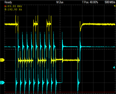

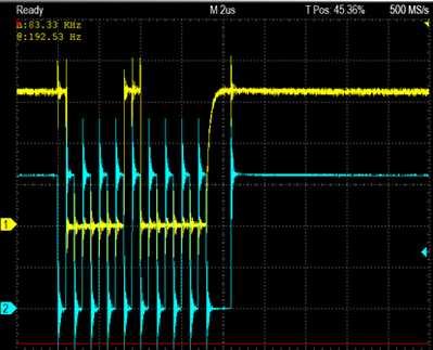

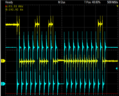

I tried simplifying my example to be even more minimal than the SDK example.
I found that the issue occurs on the Master side, rather than on the Slave side as originally assumed.
In summary, when implementing a Custom CCC with no data on the Master, using I3C_MasterTransferBlocking works correctly. However, when using I3C_MasterTransferNonBlocking, the waveform is incorrect.
The expected waveform sequence for a Custom CCC is: 0x7E -> 0xF0 (Custom CCC) -> 0x09 (Slave Address). Below, I only show the waveform for the Slave Address. The following three cases use the same Slave driver, but different Master driver APIs.

Case 1: I3C_MasterTransferBlocking (from fsl_i3c API)
-> The waveform is correct.

Case 2: I3C_MasterTransferNonBlocking (from fsl_i3c API)
-> The Slave Address sent is incorrect, resulting in a NACK.
In fsl_i3c.c
Harry
