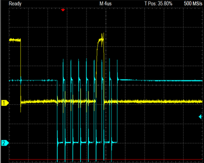

Two LPC55S36 boards were connected for I3C communication, with one configured as the I3C Master and the other as the I3C Slave. Initially, the I3C Slave was not initialized. After the Master performed bus initialization (ENTDAA), the Slave was then initialized and issued a Hot-Join event. However, at this point, the SDA line is permanently pulled low, causing the communication to stop functioning.
Test steps:
(1) Reset slave board
(2) Reset master board
(3) Click SW3 on slave board
7 Replies

bell_huang
Hi @Harry_Zhang ,
Thank you for the hint; I also modified my demo to use the fsl_i3c APIs.
After switching the Master to the fsl_i3c APIs, it can indeed receive the Hot-Join event. However, the issue is that the SDA line is being permanently held low, so the I3C bus cannot be used afterward.
Today I investigated and found that SDA is being pulled low by the Slave. I verified this in two ways:
1. Disconnect the Slave from the SDA line.
or
2. Press the RESET button on the Slave board.
In both cases, SDA can be observed to recover from low to the normal high state.
In addition, within the Slave driver, it can be observed that kI3C_SlaveRequestSentEvent is not received.
2,275 Views
Harry_Zhang
Hi @bell_huang
You can add
I3C_MasterEmitIBIResponse(EXAMPLE_MASTER, kI3C_IbiRespAck);
in master call back function.
And then the SDA will push high.
And the Slave driver will receive kI3C_SlaveRequestSentEvent.
But i found the the master can not ProcessDAA.
I need further investigation.
Harry
