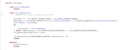

Hi there,
I'm trying to implement the flow of hotjoin with the I3C bus. However, when the target triggers the hot join address (0x02), the SCL stop at the 8th clock tick. No clock for R/W and ACK, do you have any idea?

Harry_Zhang
Hi @sam_wu_7911
When you enter Hot join,
You can try to send response ACK.
I3C_MasterEmitIBIResponse(EXAMPLE_MASTER, kI3C_IbiRespAck);
And then  dynamically assigning addresses.
Harry

sam_wu_7911
Hi @Harry_Zhang
Do you mean when the Controller received the Hot Join Interrupt, sending a response ACK?
Is it like the code below?

Harry_Zhang
Hi @sam_wu_7911
Yes, you are right. and then dynamically assigning addresses.  you can try.

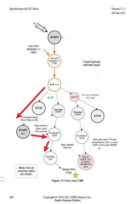

sam_wu_7911
Hi @Harry_Zhang
After applying your solution, the last two clocks appear. However, after the ack is the stop condition, and that doesn't match the I3C spec.
Following the spec, there shall be a repeated START condition rather than a STOP. Do you have further ideas?

Harry_Zhang
Hi @sam_wu_7911
In i3c spec, after the ack is the stop condition or repeated start condition.
This is my code.
You can try.
Harry
