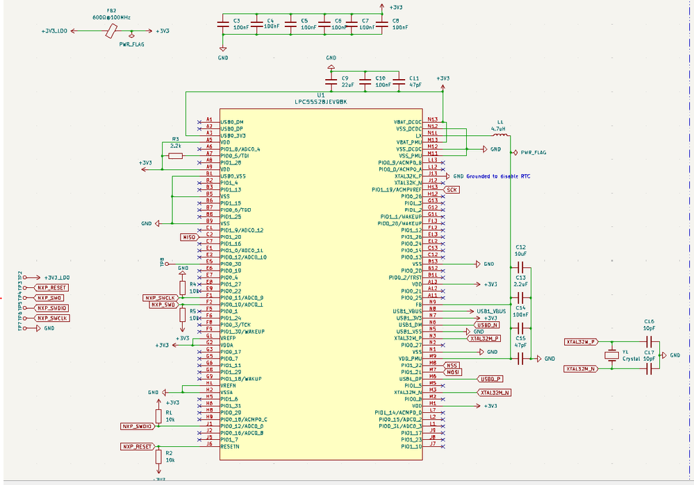

I am unable to connect to the LPC55S28 custom board. my schematics are attached
I am unable to find out any problem with this because I followed the hardware design guide exactly I don't know why its not connecting to jlink.

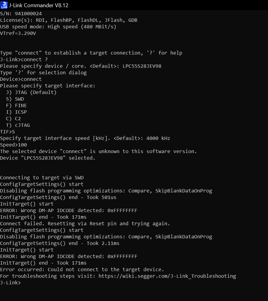

I am using Jlink commander V8.12, with Jlink version 12
The Jlink is working I am able to connect to other MCU targets. Please help where am I doing the mistake?

steve5528
@mirhamza708
Were you able to resolve the issue? I'm new to NXP world and i'm in the process of designing a custom board so I'm interested in your answer.
I don't have any additional context (so my observation may not be valid), however, i noticed that in your schematics for the TVS diode USBLC6-2SC6, the same data line is not connected to pin 1 and pin 6. In ST datasheet, it shows D+ connecting to 1 and 6, and D- connecting to 3 and 4. Could you comment?
Cheers!

mirhamza708
Yes you are correct I removed the ESD IC and it now connects to the PC via USB in ISP mode. I was able to program the MCU through the application. But it is still not working it goes back into ISP mode so I will look into it more when I find out, then I will update.

Harry_Zhang
Hi @mirhamza708
From the schematics provided, the design appears generally aligned with the hardware design guide for the LPC55S28.
1. Test the power supply and signals with an oscilloscope or logic analyzer.
2. Attempt to connect in ISP mode:
• Tie the ISP pin  to GND during power-on to force the bootloader to start.
• Then try to connect with J-Link.

mirhamza708
I connected to the MCU in ISP mode through USB1 interface. I was able to write program to it. I was unable to run the blinky example from the SDK. I used the Secure provisioning tool to program it.
I build the image there then wrote it to the MCU through USB1 interface but after restarting the MCU the device again starts in ISP mode even though the PIO0_5 pin is pulled up and a valid program is loaded. I saw in the User manual UM11126 that when the device is in the ISP mode the SWD Debug is disabled for security reasons.

Harry_Zhang
Hi @mirhamza708
From your description, it seems like the LPC55S28 is remaining in ISP mode after programming, even though you’ve loaded a valid program and ensured that the ISP boot pin (PIO0_5) is pulled high.
The ISP pin (PIO0_5) is used to force the device into ISP mode. If this pin is floating or configured incorrectly, the device might incorrectly enter ISP mode even if a valid program is present.
Action:
• Verify that PIO0_5 is pulled high with a strong pull-up resistor (e.g., 10 kΩ).
• Double-check that there are no unintended signals driving this pin low during startup.
