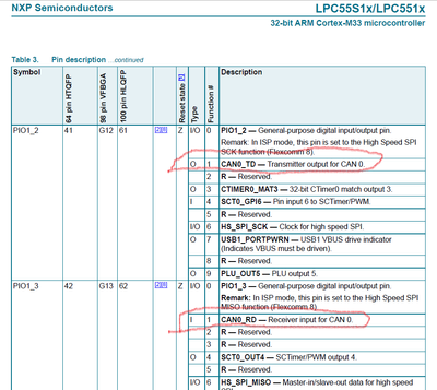

Hello Everyone,
I have tested CAN feature in LPCXPRESSO55S16 EVAL board with the (SDK) CAN example , now I'm trying the same example with LPC55S16JBD64 micro controller (custom board ) with modified pin configuration in pin_mux.c file, but I'm not getting any data, I have already raised the issue in zephyr community but this issue is more specific to LPC  micro controller so I'm raising issue here also.
modified pin_mux.c file

    const uint32_t port1_pin3_config = (/* Pin is configured as CAN0_RD */
                                         IOCON_PIO_FUNC9 |
                                         /* Selects pull-up function */
                                         IOCON_PIO_MODE_PULLUP |
                                         /* Standard mode, output slew rate control is enabled */
                                         IOCON_PIO_SLEW_STANDARD |
                                         /* Input function is not inverted */
                                         IOCON_PIO_INV_DI |
                                         /* Enables digital function */
                                         IOCON_PIO_DIGITAL_EN |
                                         /* Open drain is disabled */
                                         IOCON_PIO_OPENDRAIN_DI);
    /* PORT1 PIN22 (coords: 41) is configured as CAN0_RD */
    IOCON_PinMuxSet(IOCON, 1U, 3U, port1_pin3_config);
    const uint32_t port1_pin2_config = (/* Pin is configured as CAN0_TD */
                                         IOCON_PIO_FUNC9 |
                                         IOCON_PIO_INV_DI |
    /* PORT1 PIN27 (coords: 85) is configured as CAN0_TD */
    IOCON_PinMuxSet(IOCON, 1U, 2U, port1_pin2_config);

If I try to send CAN frame ID 0X321 with 500kbps baud rate  from PCAN_view tool , I'm not getting any echo back data in PCAN_view, but if I try the same example with modified pin_mux.c file in LPCXPRESSO55S16 EVAL board I'm getting echo data in PCAN_view tool, as well as I can see data in console.
Note: I have checked the hardware of custom board , there is no signal in CAN micro controller pins, while sending or receiving CAN frames.
Please help me to fix this issue.

The problem is with power cycle initialization procedure , the CAN driver's standby pin must be initialized during the power cycle initialization ,  I mistakenly initialized the standby pin one line before CAN tx operation , basically the standby pin must be initialized during the power cycle with some delay, I changed the code and it's finally worked for me , but whatever mentioned here is it's only works on zephyr stack not MCUxpresso IDE's SDK build still the problem is there in SDK MCUxpressso IDE build.
Thanks for your support !

As the pin assignment in data sheet of LPC551x, the Func bits should be 1 instead of 9.
So pls try to use the code in the pin_mux.c

I changed the pin_mux.c as mentioned in your comment, but still if I try to send the CAN frame I'm getting bus heavy error also I'm not getting any data in console, please let me know if any other configuration I have to change.
Thanks in advance !
