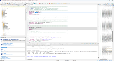

Hello @MarcoGiammarini
I received your projects. Which IDE do you used?
After import it into MCUXprsso IDE, it seems not works well. Not shows the code you mentioned above.
Just as below:
Also linker file not right.
Alice
How about send a project that I can directly build. You can send your project to others to test first.
Without any change, on my side:
 I think maybe there is issue with the linker file of application project. While project can not build well on my side, so I don't know which linker file do you used. Use IDE to config? Or use the files under linkscripts folder?
Alice
