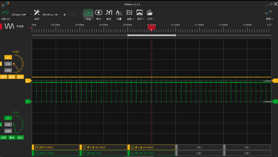

Hello everyone,
Working on an LPC55S06-EVK for future developments on LPC5506, I'm trying to output a 100Hz PWM with dutycycle change (following a gaussian curve). I'm using the example  "sctimer_pwm_with_dutycycle_change". It's working with the 24kHz pwm frequency but not with 100Hz (nor 1kHz). It never reaches 100% dutycycle (even if I pass 100 to the variable updatedDutycycle, see image below). As you can see in the video attached to this post, the pwm "jumps back" instead of going to full dutycyle.
You can find the code here : https://pastebin.com/BHBZC0hn .
Thanks for helping me.
François

My application code is not the issue because when I try this code :
void SCTIMER_LED_HANDLER()
sctimerIsrFlag = true;
updatedDutycycle = 100;
if (SCTIMER_GetStatusFlags(SCT0) & (1 << eventNumberOutput))
/* Clear interrupt flag.*/
SCTIMER_ClearStatusFlags(SCT0, (1 << eventNumberOutput));
So the dutycycle is set to 100 (thus 100%), the issue is still there (as shown in the screenshot below).
Thanks for your reply.
François

xiangjun_rong
when the updatedDutycycle1 is set up as 99, the screenshot is like the following Fig, obviously, it is correct.
XiangJun Rong
volatile uint8_t updatedDutycycle = 10U;
volatile uint8_t updatedDutycycle1;
updatedDutycycle1=99;
/* Update PWM duty cycle */
SCTIMER_UpdatePwmDutycycle(SCT0, DEMO_SCTIMER_OUT, updatedDutycycle1, eventNumberOutput);

francoisB
It's working because you set the pwm frequency to 24kHz. Could you try with 100Hz to see if it still works please ?
9,709 Views
xiangjun_rong
I can duplicate your issue, when the PWM frequency is 100Hz, the duty cycle is abnormal.
I will check the code later.
Xiangjun Rong

xiangjun_rong
Finally, I get the root cause of the issue, the sctimer driver has problem.
Pls use the following code I modified, I have tested, it works well.
the cause of the issue is that the pulsePeriod variable is 0x75300 at most in 100Hz PWM signal, when it use the macro SCT_MATCHREL_RELOADn_L(pulsePeriod); high half word 0x7 will be removed, it results problem obviously. But when the pulsePeriod is less than 0xFFFF, no problem.
#if 0
base->MATCH[pulseMatchReg] = SCT_MATCH_MATCHn_L(pulsePeriod);
base->MATCHREL[pulseMatchReg] = SCT_MATCHREL_RELOADn_L(pulsePeriod);
#else
base->MATCH[pulseMatchReg] = pulsePeriod;
base->MATCHREL[pulseMatchReg] = pulsePeriod;
#endif
Pls modify the function in fsl_sctimer.c
XiangJun Rong

francoisB
Thank you very much, it works !

francoisB
I did some measurements with my oscilloscope. You can see in the table below the time to high for different dutycycles :
dutycycletime to HIGH (µs)
1101
5501
10318
20635
30271
40587
50222
60539
70174
80491
90127
99343
100443
