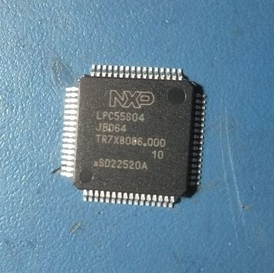

I am using LPC55S04 for one of my projects.  Firmware is finalized and is working fine on more than 20 boards.
Same code when programmed into newly purchased controllers is leading to continuous hard-faults, some times bus-fault is shown while debugging, some times FORCED fault.
Debug window shows different function names every time after halting.
these controllers also has two pin-1 markers (previous controllers had only one).
Request to please help me to find out the root cause of the issue.
