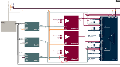

2.: In this device there are 3 DACs. DAC0 and DAC1 are OK, I use them. But: there's DAC2, and it doesn't have any output pin. The only use of this DAC2 I could find is, according to Figure 265, use it as Vref of OpAmp2. But, also on Figure 265, there's an output pin drawn. Also, on Page 93 of Reference Manual, top of page, there's PIO2_4 mentioned as DAC2_OUT. But there's no PIO2_4 pin of this device. My 100 pin package is the highest pin count variant. Did You plan an even higher pin count package for this device?

Q2)In this device there are 3 DACs. DAC0 and DAC1 are OK, I use them. But: there's DAC2, and it doesn't have any output pin. The only use of this DAC2 I could find is, according to Figure 265, use it as Vref of OpAmp2. But, also on Figure 265, there's an output pin drawn. Also, on Page 93 of Reference Manual, top of page, there's PIO2_4 mentioned as DAC2_OUT. But there's no PIO2_4 pin of this device. My 100 pin package is the highest pin count variant. Did You plan an even higher pin count package for this device?
>>>>>This LPC553x device has three instances of the DAC module, DAC0, DAC1 and DAC2. They are 12 bits resolution. I agree with you that the DAC0 and DAC1 can output the analog voltage to pads,  but the DAC2 can not output to a pad. The DAC2 output can be routed to on-chip OP AMP2 and function as a offset voltage for the on-chip OP AMP2.
Secondly, the DAC2 can be routed to HSCMP2 as an input channel 5 for both HSCMP non-inverter multiplex and inverter multiplex. The DAC2 is different module from on-chip 8 bits DAC, which is an internal module of the HSCMP.
The PIO2_4 pin does not exist for the current package of LPC553x, so I have suggest AE to delete the pin.

Thank You for the prompt answer. According to DAC2, Your answer is clear, but there's a symbol in the Reference Manual, Figure 265. At the output of DAC2, there's a little square with cross. In every other case, this symbol means, that the corresponding signal is connected to a pin, to the outside world.
When DAC2 output is an internal signal only, this little square is misleading. Other internal signals, for example OpAmp2 output, they don't have this little square.

For LPC5536, the DAC2 can not output voltage to an external PAD, so the this is a typo for the  little square with cross, I will report it to AE team so that they can modify the doc.
