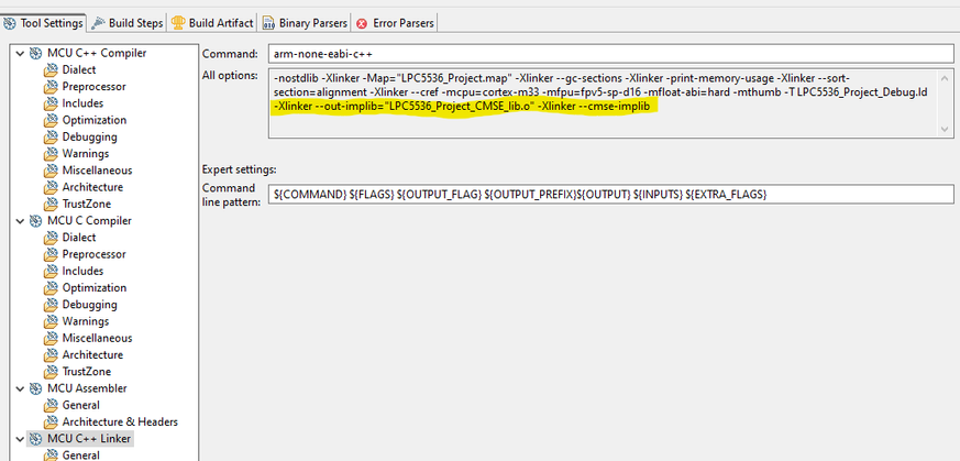

Why does this new and empty project not compile successfully?
I wonder why this '--out-implib="LPC5536_Project_CMSE_lib.o' is in the linker command line.
I also spotted  "implib" related options in the project settings, see below:
The options of the linker invocation highlighted in yellow are new to me and I have never seen them in other LPC5536 projects before.
What have I done/selected to make these command line options appear? How do I get rid of them?

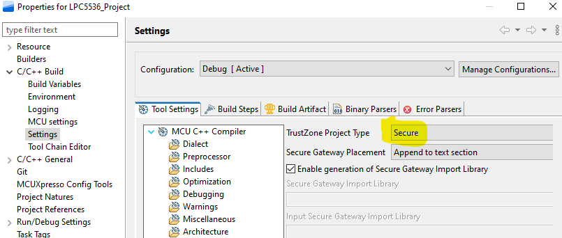

I found the setting that prevents successful compilation:
If I set this to "none", the project compiles.
I you ask me, I'd vow that I did not set TrustZone for the linker to "secure" in the new project wizard, your honor.
Case closed.
Happy weekend.
