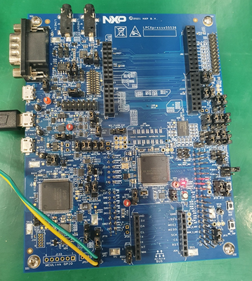

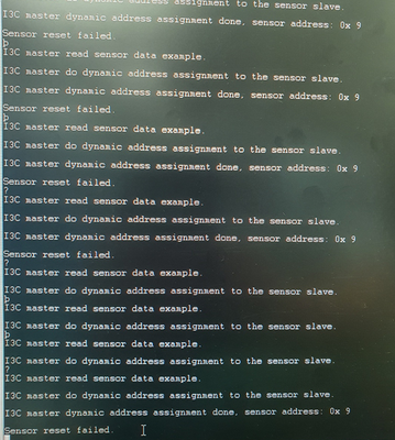

Hello team,
I'm testing i3c example of i3c_master_read_sensor_icm42688p with LPC5536-EVK.
The board was set based on the readme.txt, but the result is little strange.
demo failed with following uart message
I3C master read sensor data example.
I3C master do dynamic address assignment to the sensor slave.
I3C master dynamic address assignment done, sensor address: 0x 9
Sensor reset failed.
or
Sensor reset is done, re-assgin dynamic address
Sensor enable failed.
The board seems not to go the next step for gathering sensing data.
Two EVK were tested and result was same.
Could you check what's wrong or what I should do?

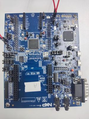

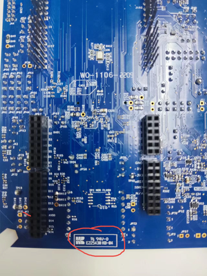

Hello mj000,
I use my colleague's lpc55s36 board to test this demo , it works well, below is the photo of that board,
while I have not find the different, you can also try to check with it. I will tell you if I find the root cause.
Alice

Hello  mj,
Do you have any other lpcxpresso55s36-EVK ? I test some other boards, all can works, only one can't.

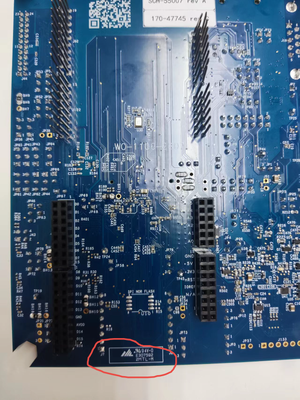

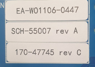

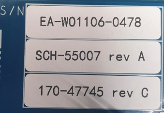

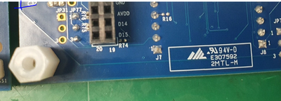

7,455件の閲覧回数
Your two boards all can't work?
I test four boards, only one can't work.
The version of chip and boards all the same, almost no different , only one point, please check it on your side as below picture:
No issue board:
What about your board?
Alice
Issue:
7,449件の閲覧回数
mj000
  • No, 2 EVK were not working as commented.
  • These are our boards which are same to no issue EVK.
MJ

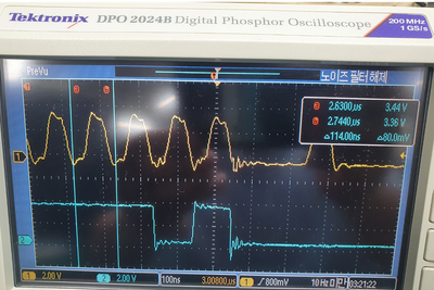

7,570件の閲覧回数
mj000
Hello NXP
Really thanks for supporting us.
When tested more, It was found that as follows
- example test procedure stopped due to the nack from the sensor.
- i3c SCL was set to 12.5Mhz in the code but real SCL was around 10Mhz by checking oscilloscope.
- When decreasing SCL to 1.25Mhz, the procedure seemed to go more, but still not working.

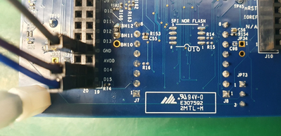

Could you please measure timing waves on SCL and SDA signal lines by using logic device? SE team ask this.
Also insert the jumper JP58.
Alice
7,493件の閲覧回数
mj000
  • SCL, SDA were measured with Oscilloscope, SCL peroid should be 80ns at 12.5Mhz, but it is around 110ns. refer to picture.
  • what deos "logic device" mean? Logic analyzer? we don't have it.
  • J58 was shorted as you can see the first picture I attatched and you can check in your EVK.
