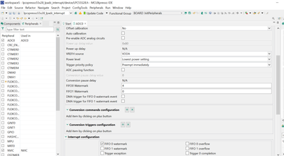

Hello @PaulaVelasco
You can use MCUxpresso configure tool to config , If still can't work, please send you project to me, I
will help to test on my side.
Alice
