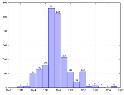

This is the output plotted as a histogram when the ADC is configured in low-resolution (full range contains 4096 code symbols):

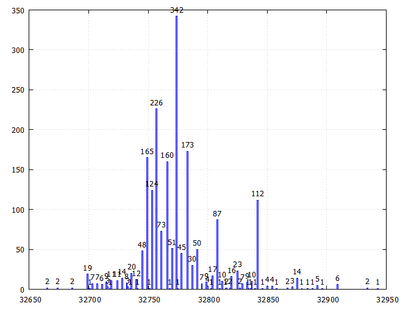

Then I change the code to configure the ADC in high-resolution using:
#define DEMO_LPADC_USE_HIGH_RESOLUTION 1
This is the output plotted as a histogram when the ADC is configured in high-resolution (full range contains 65536 code symbols) using
This is a part of the histogram data:

 Obviously some output codes are missing.
Why is this?

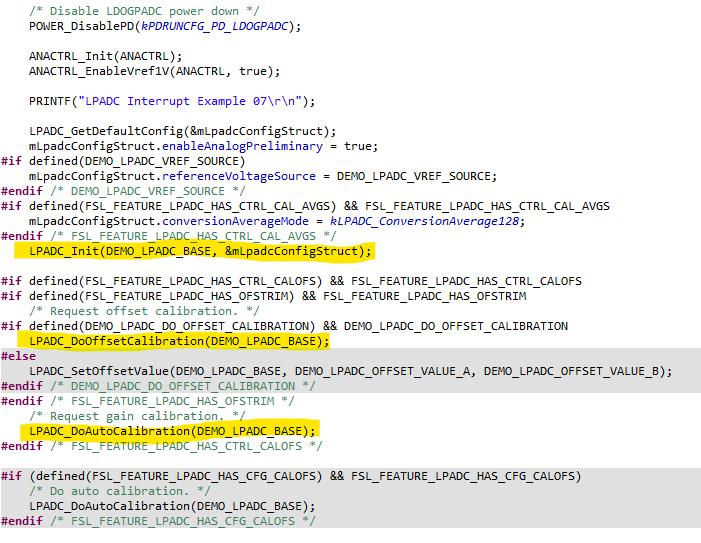

LPADC_Init(DEMO_LPADC_BASE, &mLpadcConfigStruct);
LPADC_DoOffsetCalibration(DEMO_LPADC_BASE);
LPADC_DoAutoCalibration(DEMO_LPADC_BASE);
Pls have a try.

as you know, the code I'm running is based on the "lpadc_interrupt" example from the SDK.
Starting from there, I extended the example code by adding:
#define DEMO_LPADC_DO_OFFSET_CALIBRATION true // changed to true
 This enables offset calibration. In MCUXpresso IDE the code looks like:
As you can see, the three lines of code that you provided are used in this example.

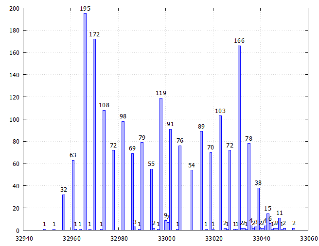

Running this code on LPCXpresso55S28 demo board with the input of ADC channel 0A (pin 4 of connector P19, i.e., pin 20 of MCU) held at 1/2 AVDD results in this histogram:
This doesn't look any better. In fact, the result on the demo board is worse as conversion results are shifted towards higher values away from the "correct" 1/2 full scale value 🤨.
Any idea why this is and what I could try next?

alex_yang
Hi ,
It's a sticky code issue on LPC55S28, which already confirm by design, will be fixed in future slicion version.
Due to deisgn request. Customer need to assign NDA if they want to see more details explanation on this.
