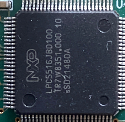

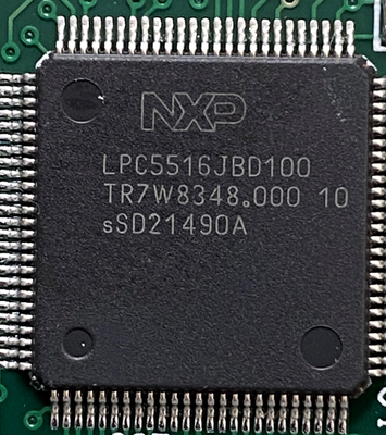

We have 2 batches of PCB's with different date codes on the CPU the one with sSD21480A  (week 48 2021) works without any problems the new batch has a date code sSD21490A  (week 49 2021) in this version the programs craches after the init.
To debug I have created a new default project with only a clock setup and this has the same problem it runs when I set the ferqeuency < 100Mhz and it crashes when its set > 100Mhz.
Any sugestions what can be done to solve this?

Pavel_Hernandez
I need more information about your MUCs, Could you give me a picture of both MCUs? Where did you buy the last lot?
Pavel
3,800 Views
jeroenbussink
I have attached a picture of a working and a not working CPU, both CPU are bought from AVNET.
