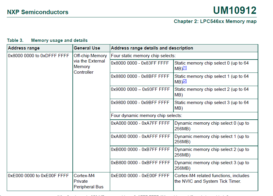

I am using LPC546xx and have found a mismatch between the SDK 2.5.0 and User Manual UM10912 concerning static and dynamic memory regions depending on Cip Select:
Static Memory Chip Select Base address
CS0: 0x8000'000 (UM10912) vs 0x8000'0000 (SDK)
CS1: 0x8800'000 (UM10912) vs 0x9000'0000 (SDK)
CS2: 0x9000'000 (UM10912) vs 0x9800'0000 (SDK)
CS3: 0x9800'000 (UM10912) vs 0x9C00'0000 (SDK)
Dynamic Memory Chip Select Base address
CS0: 0xA000'000 (UM10912) vs 0xA000'0000 (SDK)
CS1: 0xA800'000 (UM10912) vs 0xB000'0000 (SDK)
CS2: 0xB000'000 (UM10912) vs 0xC000'0000 (SDK)
CS3: 0xB800'000 (UM10912) vs 0xD000'0000 (SDK)
Which one is the correct one? SDK or User Manual?

Hi, Daniel,
The UM10912 description is correct.
Hope it can help you
XiangJun Rong

Hi Rong
So how can I fit up to 256 MB into the dynamic memory sections without writing into the next section?
0xA000'0000 - 0xA7FF'FFFF allows a maximum of 128 MB NOT 256 MB.
I believe the User Manual is also wrong!
Dani

Hi, Daniel,
For the SDRAM address map Table, I think the size 256MB is correct, but the address range is incorrect.
Pls download the an12026.pdf from the link:
https://www.nxp.com/docs/en/nxp/application-notes/AN12026.pdf
it gives the chip select for both DRAM and SRAM.
XiangJun Rong

danielgull
Great information - thank you Rong - Wish you a great weekend. I should be able to work with this now.
Many thanks
