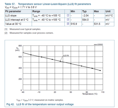

Pls refer to table 57 in data sheet of LPC546xx, which can be downloaded from the link:
https://www.nxp.com.cn/docs/en/data-sheet/LPC546XX.pdf
assume the voltage is x, y is the temperature. The formula is y=k*x+b
the k is -2.04mV/C, b 584mV at 0 degree..
Hope it can help you

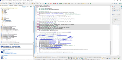

As you know that the temperature sensor is connected to channel 0 of ADC for LPC546xx, so you have to select ADC channel 0. Secondly, there is an Input Select register in ADC converter, you have to set the reg as 3 so that you can select temperature sensor. For detailed inf, pls refer to section 44.6.2 Input Select register in UM10912.pdf
I have used the lpc_adc_interrupt as an example and changed it as following so that you can sample temperature sensor, pls have a try.
XiangJun Rong

Can you download SDK package and use the SDK adc example to test the temperature sensor? If the SDK example is okay, then refer to it to develop code based on register instead of driver.
https://www.nxp.com/design/software/development-software/mcuxpresso-software-and-tools-/mcuxpresso-s...

I got the reading. Can you give me the formula for calculating the temperature with the resultant converted hexadecimal value for LPC54608, 12 bit ADC.
5,397 Views
xiangjun_rong
