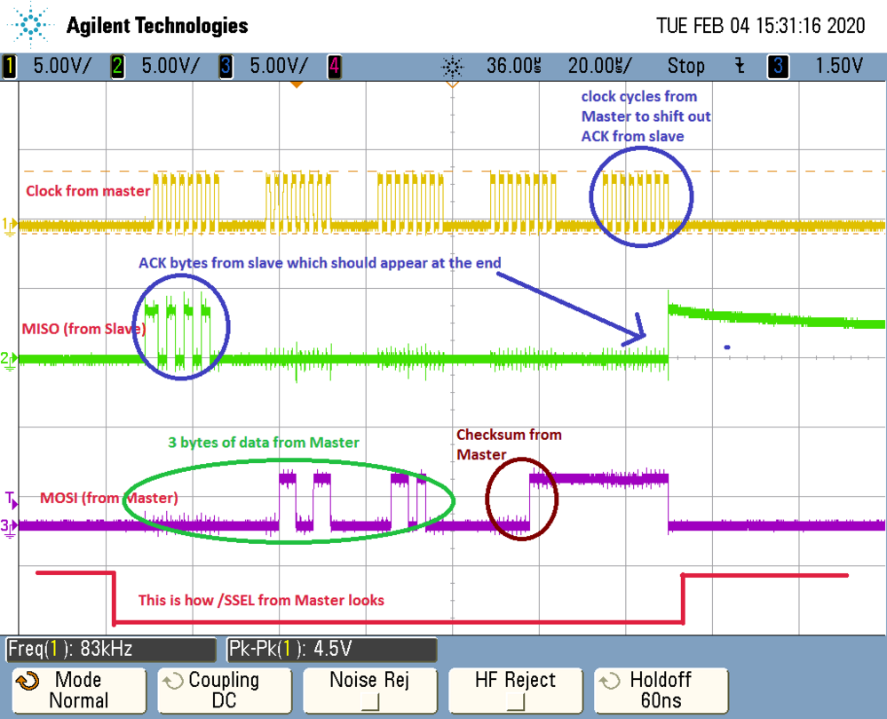

There are two LPC54628 of which one acts as SPI Master and the other SPI Slave.
This is my requirement:
The SPI master sends 5 bytes of data in 8 bit SPI mode: the first 3 are data bytes and the 4th is checksum (XOR of first 3 bytes). After this, the master sends 8 clock cycles (5th byte) in order receive acknowledgement from the slave to know whether it received data without errors.
The SPI Slave receives the four bytes from the Master, calculates checksum and compares with the received checksum. If they match, the slave loads a acknowledgment signal (0xAA) which gets shifted out from the slave to the master as the master sends the 8 clock cycles.
What works:
The master works fine. The slave works fine till the calculation and comparison of checksum.
What doesn't work:
When I load the acknowledgment byte 0xAA into the SPI slave, I expect it to be shifted out to the master as the master sends 8 clock cycles in the 5th byte of a frame. But on probing, i find that the ack byte is being sent out only in the 1st byte of the next frame. What is happening? Please help.

SPI Master settings are near identical, with baud rate set at 50kbps. Both microcontrollers run at 96MHz.

Hi, Aswin,
I think there is a bug when the SPI module is used as slave device and transmitter, the workaround is to fill the 8 level transmitter FIFO with dummy data before the SPI slave transmits any data.
Hope it can help you
XiangJun Rong
2,478 Views
aswinprabhu
I was able to solve the issue by setting SPI_ClockPhase as kSPI_ClockPhaseSecondEdge instead of FirstEdge.
Thank you.
2,478 Views
xiangjun_rong
Hi, Aswin,
If you toggle the /SS pin of slave SPI for each data transfer, the bug does not appear.
XiangJun Rong
