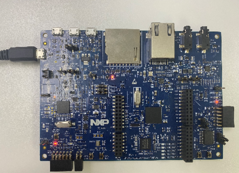

ZhangJennie
I tested LPCXpresso54628 demo board as below setting, no problem connect the board
I suggest you check below points:
0. make sure you use the latest MCUXpresso IDE version and latest SDK.
1. create a NEW project under a NEW workspace. test connection.
2. test the board with another computer.
3. update on board debug firmware with LPCScrypt.
LPCScrypt v2.1.1 | NXP

ZhangJennie
Could you please try on board debug interface? It's J8 on board.
if can't connect with J8, shunt DFU to update the on board firmware, if CMSIS can't connect, try Segger
