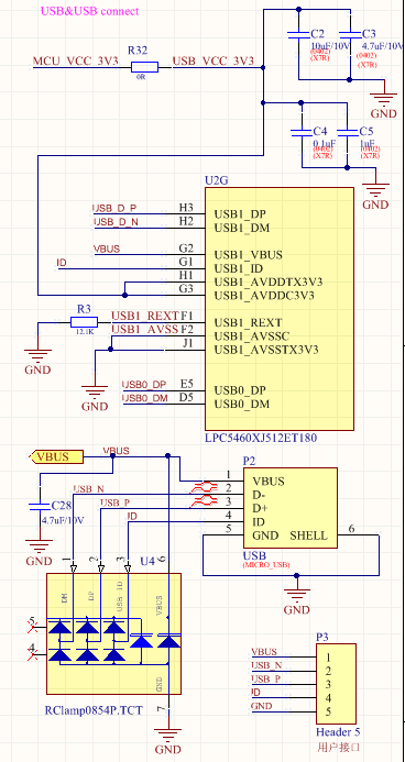

             We designed our LPC5460X board refer to NXP EVB, it works good at first, but after hot swapping and hot insertion  several times, the CHIP USB1_AVDDTX3V3 and USB1_AVDDC3V3 are short circuit to GND, do you know what operation could cause this problem ? (If don't supply USB1_AVDDTX and USB1_AVDDC3V3, the MCU software still can run)

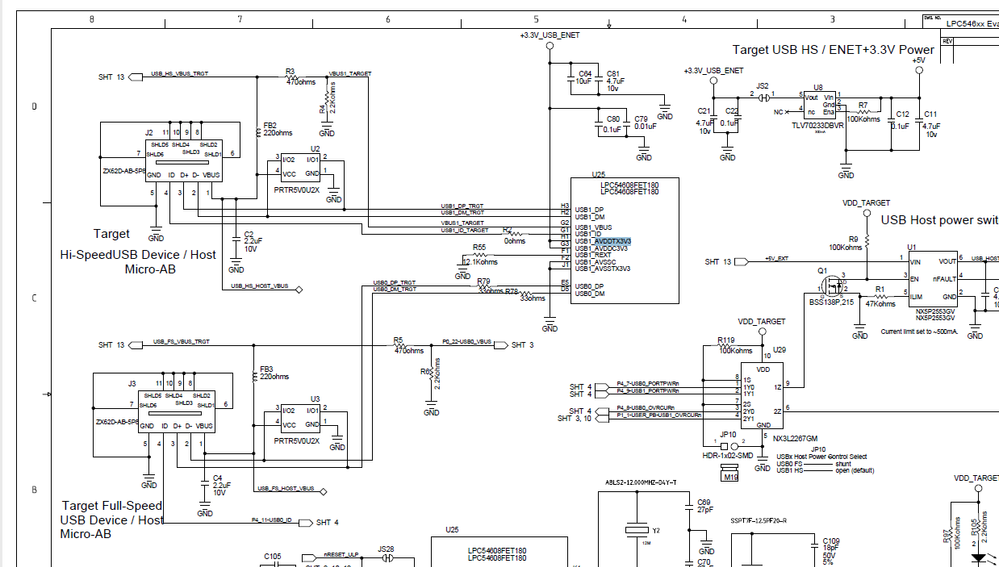

kerryzhou
Hi Yanqinghe,
     How you design your circuit in AVDDTX3V3?
    This is the official board schematic, you can refer to it, and compare it with yours:

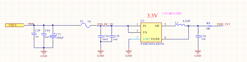

yanqinghe
Hi Kerry
       Thanks for your reply, I think it's not solder problems ;I connect the USB1_VBUS directly from connector, like the follows picture.
MCU_VCC_3V3 is generated by a LDO(input is VBUS);
I saw the LPC546X datasheet suggested USB interface solutions as the follow picture shows, it has some restriction for USB_VBUS, I'm not sure if this cause the problem :
                    Is this the reason USB1_AVDDTX3V3 and USB1_AVDDC3V3 are short circuit to GND after  hot swapping and hot insertion  several times ?

kerryzhou
Hi yangqinghe,
    From your schematic, your USB1_VDDTX3V3 and USB1_AVDDC3V3 already from the LDO, not from the VBUS directly, it should not have the problem about the VDD power slow than the USB_VDDTX3V3.
   I checked your method with the lpcxpresso LPC54608 board, the official board use two different LDO in MCU VDD and USB VDD, so, do you try to hot plug the official board, whether it have problem on your side or not? It seems still somewhere hardware circuit have problems.
