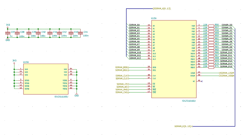

I've designed a custom board with LPC54608J512BD208 and IS42S16160J-7TLI following the OM13098 schematics (RevF) as a reference. Here's my current SDRAM connection
Everything goes well with the board... except the SDRAM test. I've run the lpcxpresso54608_emc_sdram example provided by the SDK (v2.7.0) and the test fails at line 24 of the next of SDRAM_AddressBusCheck function.

In this case, address[0] = 0xaa2aaa2a so it does not match with the expected result (0x55555555). Previous loop (line 16) is terminated successfully.

Higher values for CMD_DELAY and FBCLK_DELAY ?
I use 0x1010 on 54608 running at 180 MHz and EMC at 90 MHz. I use the same value on projects with the 54628 running at 200 MHz and EMC at 100 MHz. This does not mean that it is a "universal value" that works for all. I could also be something else with the design/setup.
Have you tried all kinds of bit patterns to see if they work ?

xiangjun_rong
Hi, Gaston,
pls try to adjust the setting of the EMC clock delay control register and check if you get improvement as Garsten said.

At the end I have come to the conclusion that the PCB design (routing, stack-up) is not very suitable for the required SDRAM speeds. I will have to redo the design prioritizing this point.

From your description, I see that you use the similar SDRAM chip as the that of LPC54608 evaluation board and the example code in SDK package. I think the code is okay, because most of reading data are correct.
Regarding the issue that you write address[0]=0xaaaaaaaa, but you read as 0xaa2aaa2a, obviously, the D7 is read as 0 which should have been 1. I think it is a hardware issue, for high speed SDRAM access, you have to consider the signal integrity, in other words, 4 layers board, all data bus pins should connect to a serial resistor which locates as close as possible to the SDRAM data bus. BTW, if you decrease the SDRAM clock frequency, what is the result?

Hi Xiangjun, I'm not sure is a Harware issue.The design includes a 4-layer PCB (one internal layer as solid GND) and the distribution is close enough (I hope) with the 22R resistors connected to the data bus.
Indeed the sdram test fails at the mentioned line. However if I write (outside from the test routine) ~0x55555555 at 0xA0000000 and read back from the same address I get 0xAAAAAAAA as expected.
In fact, there is no problem if I write/read back a 32-bit word to/from any SDRAM address in this way:
*(uint32_t *)(sdram) = ~0x55555555;
    readData = *(uint32_t *)(sdram);‍‍‍‍
Why can't I pass the full test?
It's really puzzled me.
I've also tested it with lower EMC clks for example:
basicConfig.emcClkDiv = 1, 2, 3, 4, 5 and even 6 without success...
