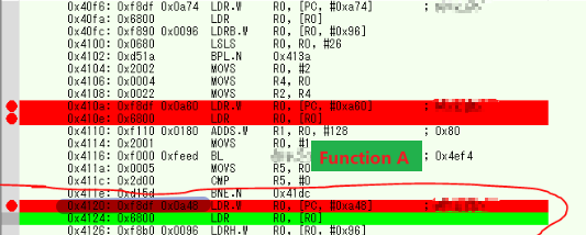

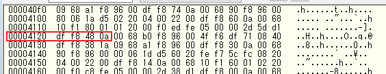

"0xf8df0a48"(correct code) is the content on program code segment 0x00004120 (on-chip-FLASH's address).
IAR memory_correctIAR memory_correct
When I debug and execute code (running code on on-chip-flash), everything seems to be running smoothly from the beginning.

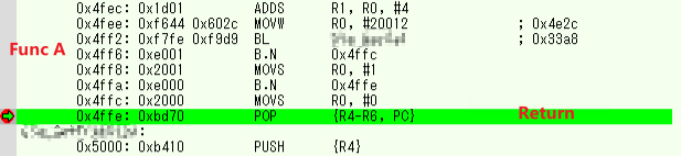

However, at the moment Function A returns, the content of program code segment 0x00004120 has been changed from "0xf8df0a48" to "0xf8df0848". (I don't know why this is happening, I would like to ask for your opinion)
IAR disassemblyIAR disassemblyFunction AFunction AIAR memory_errorIAR memory_error
Therefore, a hard fault interrupt occurred while executing code "0xf8df0848" (which should have executed “0xf8df0a48"), and after entering the hard fault interrupt, the content of program code segment 0x00004120 changed from the wrong "0xf8df0848" to the correct "0xf8df0a48" again, which felt too incredible!
