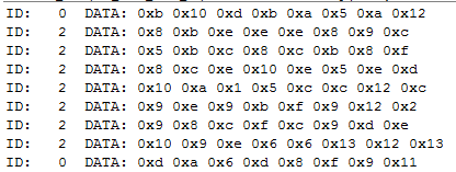

Is there any example of canbus driver for lpc546 family. I have no experience about can communication. There are two examples in SDK but I could not understand clearly how can works. I have another board which sending messages via canbus. I just know communication frequency is 500 kHz and sending 8 bytes each time and its IDs are 0x000 and 0x002. I want to listen what it is sending to me via canbus. Could someone help me to do that?
I see datas via logic analyzer but I don't know how to init can0 or can1 on my lpc54608 uc.

It is okay now. I defined new array and matched it with rxFrame.data. It is working now.
for(int a=0;a<8;a++) {mydata[a] = rxFrame.data[a];}
Code is below for someone stucks here. Thanks jeremyzhou

Okay then I move with can loopback example in SDK. But could not achieve the goal. I just want to see datas in my side.
My init code is below.
I know datas coming in 8 byte mode with 500kHz and has normal id. other nodes ids 0x000 and 0x002. I expect to see datas in picture 1 but I see datas like in picture 2. and datas in 2nd picture is meanless. There are 15 bytes ? and I see
that datas are coming even if I dont connect wires to bus. I know that's all are basic infos but I get stuck.

I did sth but now have a new problem, I see some datas, receiving datas in fifo0 but I don't know how to see them in buffer.
These are datas I want to see but don't know how to use them. For example I want to use switch case structure according to first data but I don't know how. Could you help me ?

I'm not very clear with your qustion, whether you want to recognize the particularr frame via checking the first byte in its format.
If yes, it's eaisy to do it, as the recevied frame will be stored via the MCAN_ReadRxFifo function in the CAN0_IRQ0_IRQHandler function.

I know my questions are simple but I'm trying to achieve the goal. According to code below I wait to see some output if any byte in frame is 0xa. But I am missing something I don't know.

According to this output I did or understand something wrong. Could you tell me what is the missing point ?

fatihozen
Hi jeremyzhou‌,
I know what datas I should see on my side on canbus. There is a problem again. When I use semihost console datas have expected values. In second byte(column) I must see all zeros.But if I use UART console I see there some non-zero values. What does cause this ?
12,390 次查看
fatihozen
