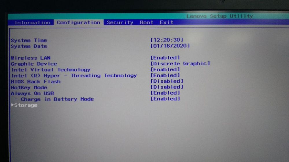

Did you enable the USB remote wake support in BIOS? If you check the following path in the SDK there's the steps need it to run this demo.
SDK_2.7.0_LPCXpresso54628.zip\boards\lpcxpresso54628\usb_examples\usb_suspend_resume_device_hid_mouse\bm\readme.pdf
Also could you try testing with other hub ports to see if its the same?

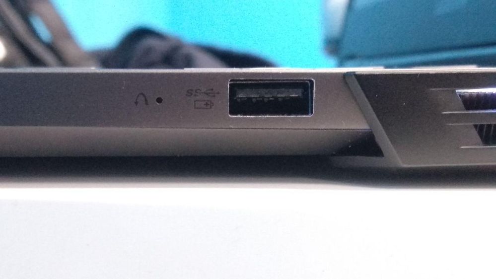

Hi Alexis, Thanks for your answer. I have checked bios, and there are no options for the remote wake. bios.jpgThis laptop can be waked up by different devices from any USB port, so I assume that remote wakeup is enabled by default.
I have also checked power settings.
I read the readme.pdf and followed every single step, but the problem still appears.

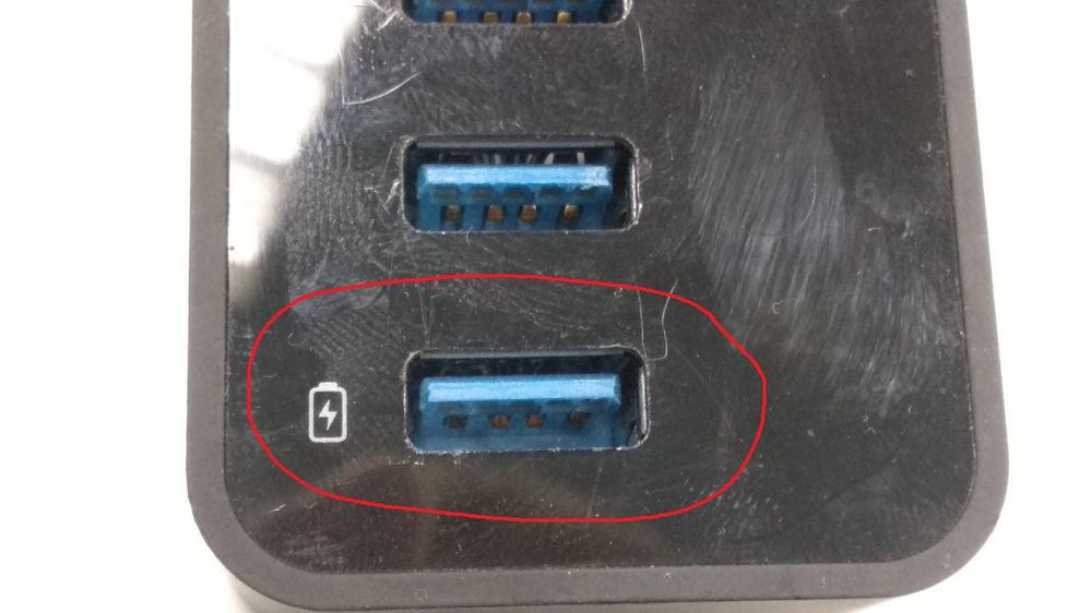

suspend_resume_hid_mouse_bm example works fine with other ports of this laptop, and with other ports of hub.
But it doesn't work in charging ports. Pictures below.
I have tested 7 USB keyboards and mice and they were able to wake host in charging port. The problem appears only with LPC546.
