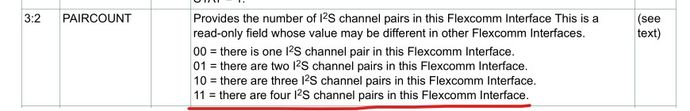

But why :
1)The same user manual have CFG1 register configuration 3:2 PAIRCOUNT
with option to set 4 channel pairs in (see attachment)CFG1_pairs.jpgCFG1_pairs.jpg

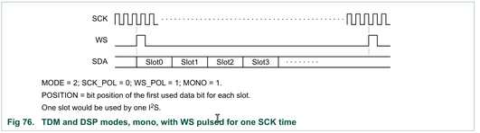

2) Fig.76 show 4 slots on diagram in TDM and DSP modes, mono, with WS pulsed for one SCK time

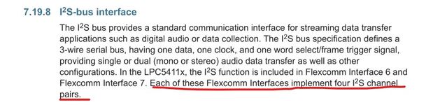

3) LPC5411X datasheet on 7.19.8 chapter states that
"In the LPC5411x, the I2S function is included in Flexcomm Interface 6 and
Flexcomm Interface 7. Each of these Flexcomm Interfaces implement four I2S channel
pairs"
It seems pretty aligned with
DSP mode packs channel data together in the bit stream and
does not use WS to identify left and right data and
each data transfer between the bus and the FIFO will be a single value with
FIFO configured as 32 bits wide and 8 entries deep.
