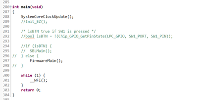

Hello Ken,
I have checked your project on my side,there is some conflict about the pin configurations in your bootloader code and application code.
When I disable //Init_EZ(); in your bootloader project, the LED on application project can work.
So please check Pin configuration carefully, or you can test resetting pins before jump to application .

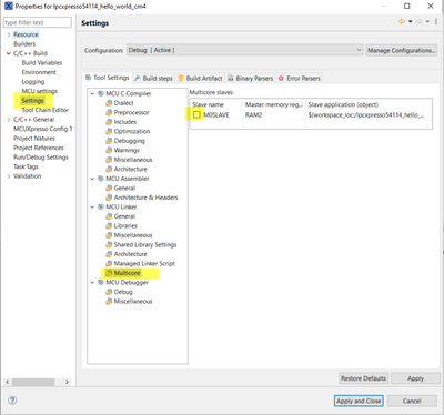

Hello Ken,
Ok, thanks for your sharing.
Just uncheck "M0SLAVE " as below will separate build M4.bin.
Alice

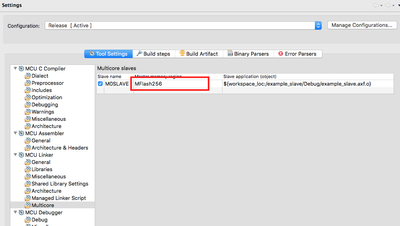

I know this trick but I cannot do the reverse, i.e. I cannot add the example_slave.axf.o back here. The IDE didn't allow me to set the "Master memory region" to RAM2. It will automatically switch back to MFlash256.
When I need to debug the slave, I need to switch the things back to "single bin file with both master and slave" and use the IDE to step through it. Can you suggest how to add the M0SLAVE back to the master project?
