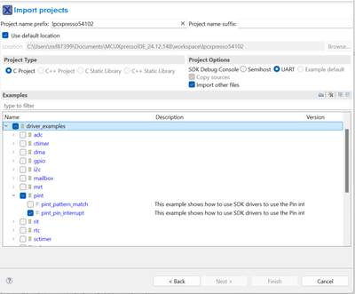

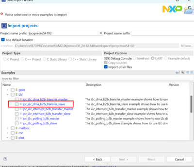

In MCUXpresso SDK for LPC54102, the following examples demonstrate partial functionality you need:
1. i2c_dma_b2b_transfer_slave
This shows how to:
Configure the I2C master for DMA-based receive.
But this does not include GPIO interrupts.
2. pint_pin_interrupt
This shows:
How to set up a GPIO pin interrupt using the General Purpose Interrupt.
You can combine these two examples to achieve your functionality.
