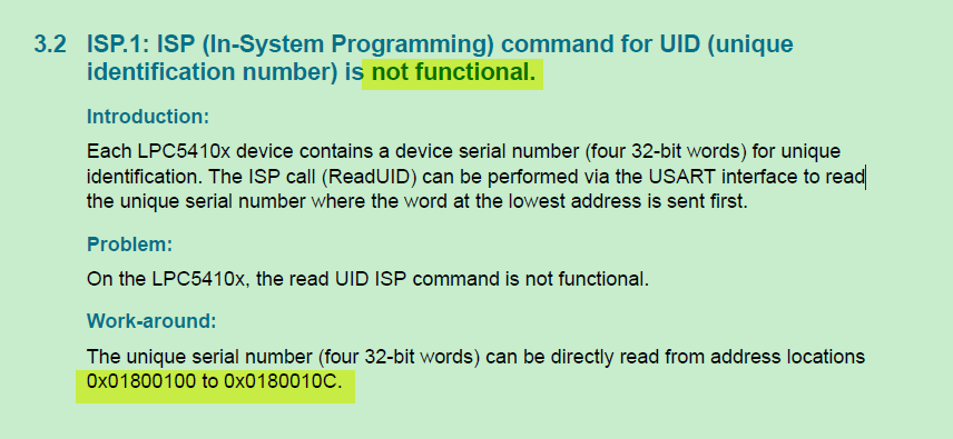

 But, please take care, in lpc54102, the errata has some description about it:
http://www.nxp.com/documents/errata_sheet/ES_LPC5410X.pdf
So, just like the workaround, pleas read the flash address directly.

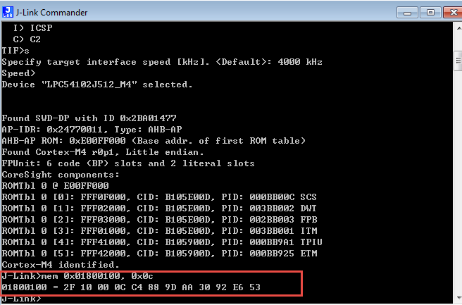

Take an example, I use the JLINK commander to read these bytes:
You also can try it like this, I also use teh LPCXpresso54102 revA, OM13077.

I have installed J-link612 software in my PC (WINDOWS 7 OS) and connected the LPC54102 board
When i open the J-link-commander, it shows the following error
there is no name or ip related to lpc54102 in  connection method tap. .
What i have to change to make this as work?

Have you flashed your board with the J-link firmware, and repowered the board to boot with that firmware (remove the DFU jumper)? Use LPCScrypt to do that (nxp.com/lpcscrypt). J-link firmware is not installed by default (CMSIS-DAP) is.
BTW, you don't have to use J-link to use the ID. Kerry is just showing you a way to leverage the Segger software to easily see the ID. Another way to do that is to use the free Flash Magic tool (www.flashmagictool.com).

   Flash Magic is using the ISP, just as I told you, ISP to read the UID have bug.
   About the JLINK commander problem, you must use your board is using the JLINK firmware at first.

                    Thank you , i have validated and it is working fine.
