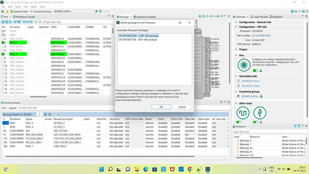

   We're using LPC54018 (208 PINs) customized board, we're trying to connect a TFT (ST7789v) through SPI interface. We're using FLEXCOMM9, configured peripheral clock as 96MHZ and updated the package to 208 PINs through MCUxpresso config tool. We're getting clock and data still the display doesn't shown the correct data/ didn't get refreshed?

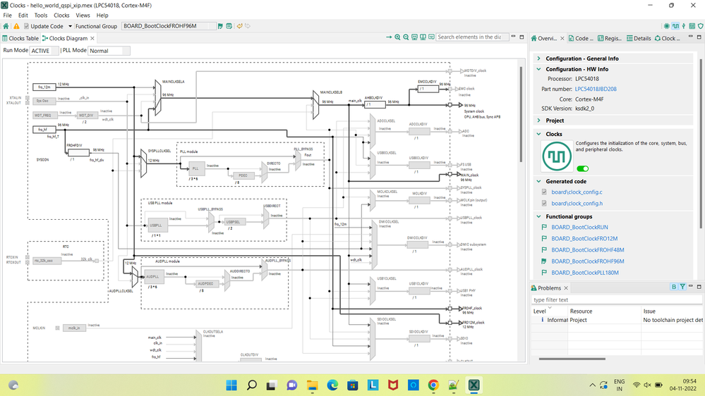

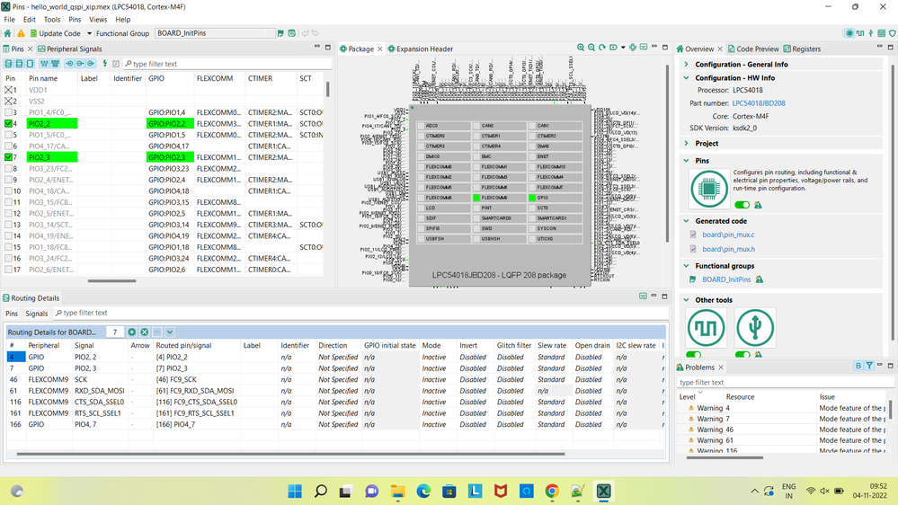

1) Hereby, I have attached the .mex file and screenshots of pin & clock configurations in the MUCXpresso config tool for your reference.
PIN configurations:
LPC54018 - Package selected as 208PIN:

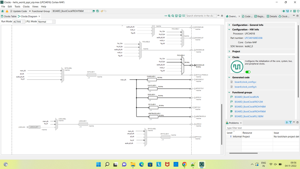

System Clock configured as 96MHz:
Flexcomm 9 (SPI) peripheral clock configured as 96MHz:

So in the CRO, the signal is SCK (PIO3_20) of SPI 9?
FROM your code, the baudrate is 50000:

2) About clock configuration, you can config refer to your requirement. You can see the Hello world XIP and no-xip demo under SDK, they all use BOARD_BootClockFROHF96M().

We updated the clock using MCUxpresso Config tool
We also tried using the BOARD_BootClockFROHF96M(), in this too we're getting the clock signal still we didn't see any changes in the display.
