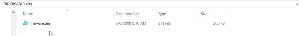

Hi Martin,
I think this is due to the computer you're using. First when you connect the device it should have a binary containg the previous firmware. You need to erase it before drag and drop the new file.

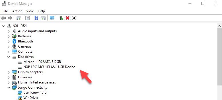

Also the device should be recognized as the following one.

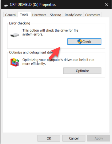

mrezab
Hello Alexis,
thank you for the reply.
Unfortunately I cannot switch to different USB, because it's currently hardwired on the PCB.
Trying to check for errors doesn't help, because clicking the Check button in CRP DISABLD's disk properties yields message"The disk check could not be performed because Windows can't access the disk".
I'll have to find some other way.
Martin

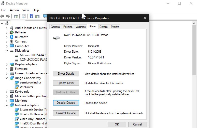

Alexis_A
Dear Martin,
It's a shame that is already hardwire to your windows 10 computer. Also other think you could try is uninstalling and installing the device in the device manager or if this doesn't work either update the driver that is using.
Let me know if this helps you.
