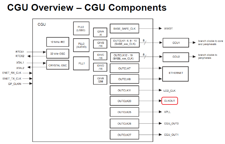

The following figure is for LPC4370 CGU and You can see CLKOUT in red color

   1. Select the clock source for CLKOUT in CGU BASE_OUT_CLK, take an example, if you select the crystal oscillator.
Chip_Clock_SetBaseClock(CLK_BASE_OUT, CLKIN_CRYSTAL, true, false);

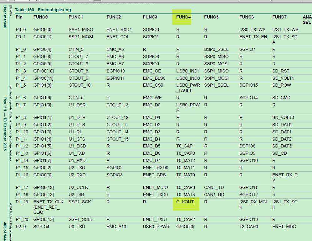

    2. Configure the P1_19 function as CLKOUT in register SFSP[1][19].
From the user manual, you can get that the CLKOUT is the FUNC4.
So, you can use this code to configure it:
Chip_SCU_PinMuxSet(0x1, 19, (SCU_PINIO_FAST | SCU_MODE_FUNC4));

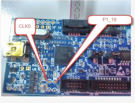

4. About the P1_19 test point position, please refer to this picture:

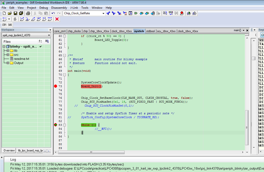

5. About the code, I modify it in the lpcopen systick
Because the external crystal is 12Mhz, then I can get 12Mhz in the P1_19.
You can test it on your side.
