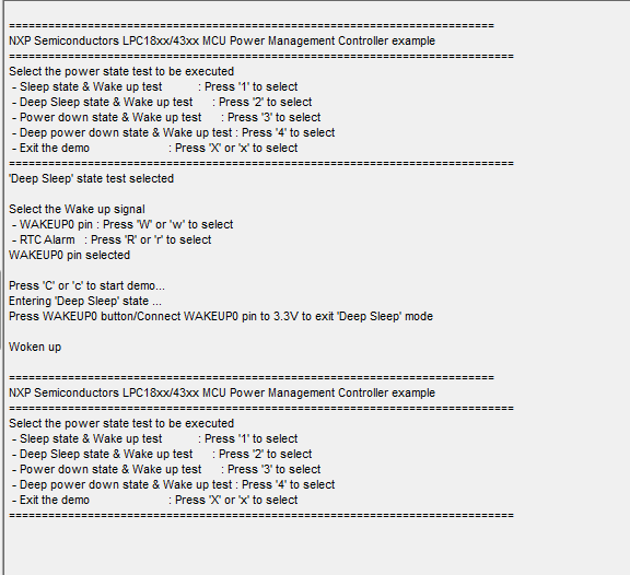

jeremyzhou
Hi julien brissard,
Thanks for your reply.
The thread indicates that "here is a known bug in software that causes the part to not wake up properly from any low power state other than Sleep mode. To fix the wake-up for Deep-sleep,call "Chip_Clock_EnableCrystal();" upon wake-up from Deep-sleep mode (you can add it on line 347 of pmc_states.c). "
My LPCOpen version is lpcopen_2_20_keil_iar_keil_mcb_4357, the following figure illustrate the testing result.
TIC

julienbrissard
Hi jeremyzhou,
Thanks to you, i finally be able to Wake-up from Deep-Sleep mode.
I have to explain that for getting this result :
1- the call of "Chip_Clock_EnableCrystal();" shall be done just after "
Chip_PMC_Set_PwrState(Pwr_state);". If you do it before it is not working
2- You shall not write PD0_SLEEP0_HW_ENA register, even if it is explained in the user manual !!
(See forum subject "Deep-sleep issue with PD0_SLEEP0_HW_ENA register" / https://community.nxp.com/thread/419958). My mistake was that in the first try, pmc_states example let me locked in deep-sleep mode (or power down?), and by following UserManaul and adding this insctruction (write 1 in PD0_SLEEP0_HW_ENA) I was able to leave this state (but Wake-up induced a reset). And combination of writing PD0_SLEEP0_HW_ENA register and Chip_Clock_EnableCrystal() do not work.
I finally try to start from pmc_states example and just add Chip_Clock_EnableCrystal();" just after "Chip_PMC_Set_PwrState(Pwr_state);" (as you mentioned in your last post), and it works :-).
I hope that User Manual will be updated soon for other users.
