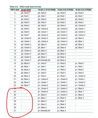

I am trying to connect a TFT screen via a parrallel RGB interface, seems simple right?
 The LPC4088 in 24 bit RGB only uses 3 out 4 byte of DMA RAM (wasting 1 byte)

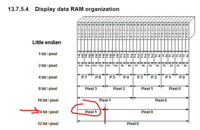

I could not find any driver mode that work in emwin that allows this. ALL the linear drivers seem to remove this wasted byte:

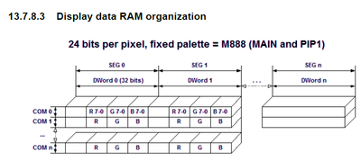

Only a driver GUIDRV_S1D13513 that is build for the Epson S1D13C00 seems to do that but that seems to be device specific:

Hi @remibusseuil,
Unfortunately, no. It is by design that the 24-bit RGB only uses 3 out 4 bytes of DMA RAM on the LPC4088, so it cannot be changed.
