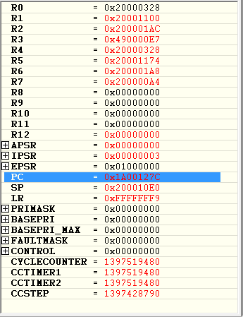

Hi all,
We are currently evaluating USB CDC function on LPC1837 NGX evaluation board and using demo downloaded from LPCOpen Software for LPC18XX|NXP .  The cdc_uart project has been successfully compiled in my computer and can be downloaded into the target with JTAG . However that demo cannot run successfully in my evaluation board since I cannot find any USB-to-UART device in my computer. When I use JLink to debug the code, I found that "USBD_API->cdc->init" in vcom_init always cause the hard fault. Notice that "init" function will call rom usb driver, so it seems that this problem is related to boot room driver? Any ideas on how to solve those kinds of problem? The value of registers when chip enter into the hard fault are listed below:

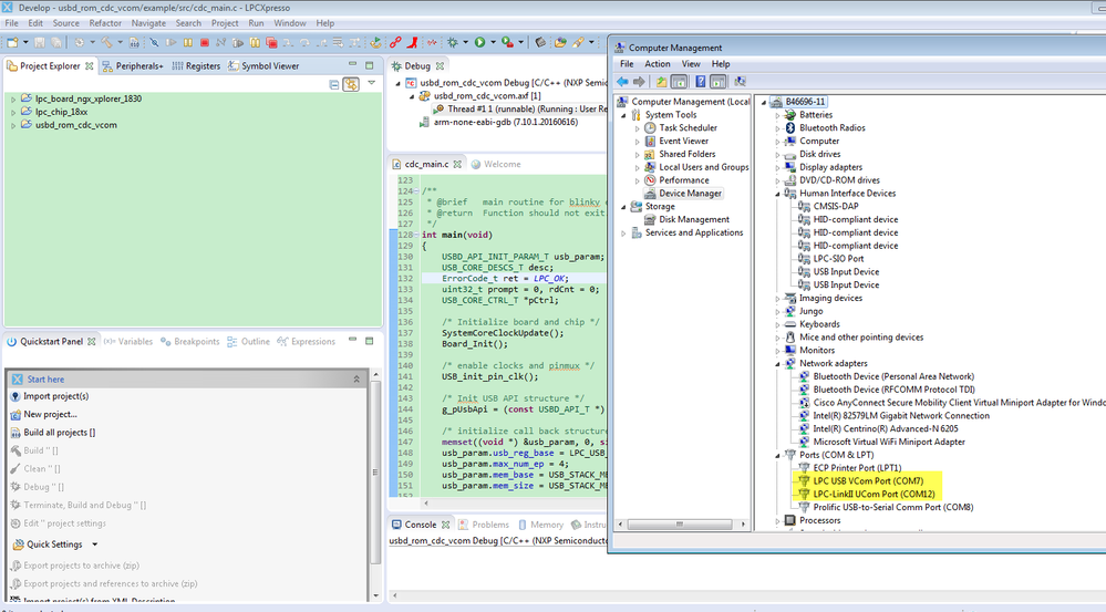

Hi Yuanbin,
   Please use the attached LPCXpresso IDE lpcopen project.
   This project don't have the problem.
Wish it helps you!
Kerry

Dear kerryzhou
Thanks for your reply. This question has been dealt  and it seems that it is a bug under the IAR Platform. That causes by the simultaneous usage of USB and DMA in AHB SRAM region. When I altered usb_param.mem_base=0x20000000 to usb_param.mem_base=0x20008000, all problems have been solved. By the way, any tools to test the usb speed between computer and evaluation board?

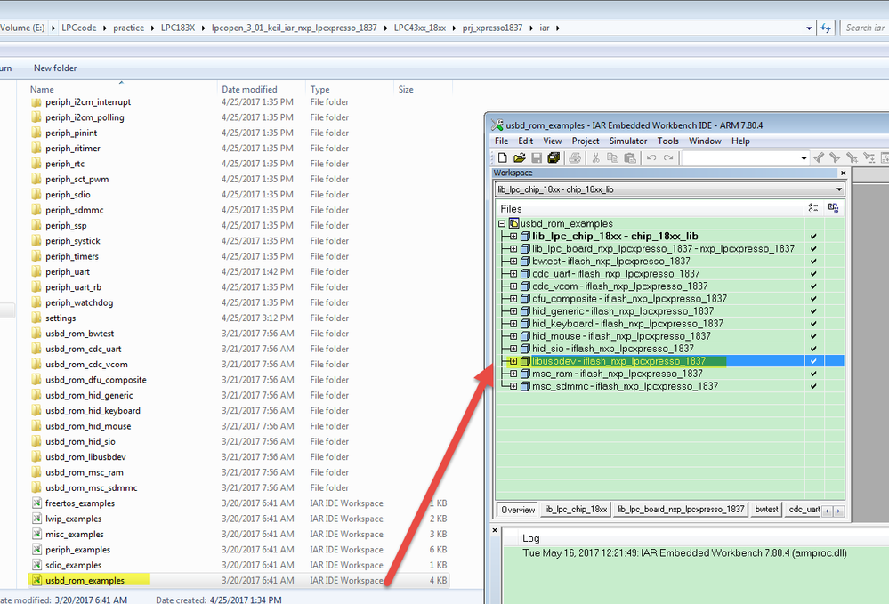

Thanks very much for your help. Currently I find an example related to libusb under directory "lpcopen_3_01_keil_iar_nxp_lpcxpresso_1837\LPC43xx_18xx\prj_xpresso1837\iar\usbd_rom_libusbdev". However there only exists files extended with "dep" and "ewp", I did not know how to compile it. Could you please help me?

kerryzhou
Hi Yuanbin,
    1. usbd_rom_libusbdev build
 Please refer to the following picture.
