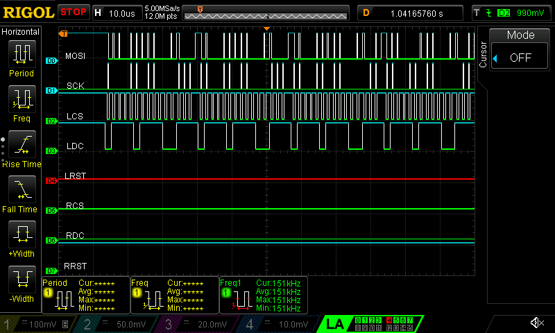

Here is the shot from the scope which I find it very interesting.
Looks like SCK and LCS (CS actually) are switched their places. I thought that I swapped the probes by mistake. No, it wasn't actually, they were correct. I've also traced back the connections up until the LPC18S37 pins. They are also correct.
From this point, before I continue my troubleshooting on the LCD interfacing, I like to understand what happens here. For example, am I making a mistake in pin muxing and it is resulting in this issue? Any pointer greatly appreciated.

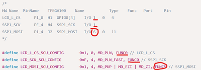

Helllo sener,
If pin mux configuration like your below comment, it is wrong.
HW Name  PinName    TFBGA100	Name	       Type    Func   Port     Pin
LCD_L_CS      P1_0	H1	GPIO0[4]	I/O	1	0	4
SSP1_SCK      PF_4	H4	SSP1_SCK	I/O	1
SSP1_MOSI     P1_4	J2	SSP1_MOSI	I/O	6	0	11
 Alll the Func number need subtract  1.
Alice
2,112 Views

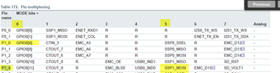

sener
Thank you for your response Alice.
But, I can't see if it is wrong with the function number.
/* Pin function */
#define FUNC0 0x0 /** Function 0 */
#define FUNC1 0x1 /** Function 1 */
#define FUNC2 0x2 /** Function 2 */
#define FUNC3 0x3 /** Function 3 */
#define FUNC4 0x4
#define FUNC5 0x5
#define FUNC6 0x6
#define FUNC7 0x7
