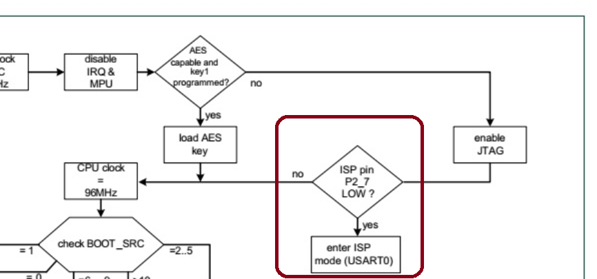

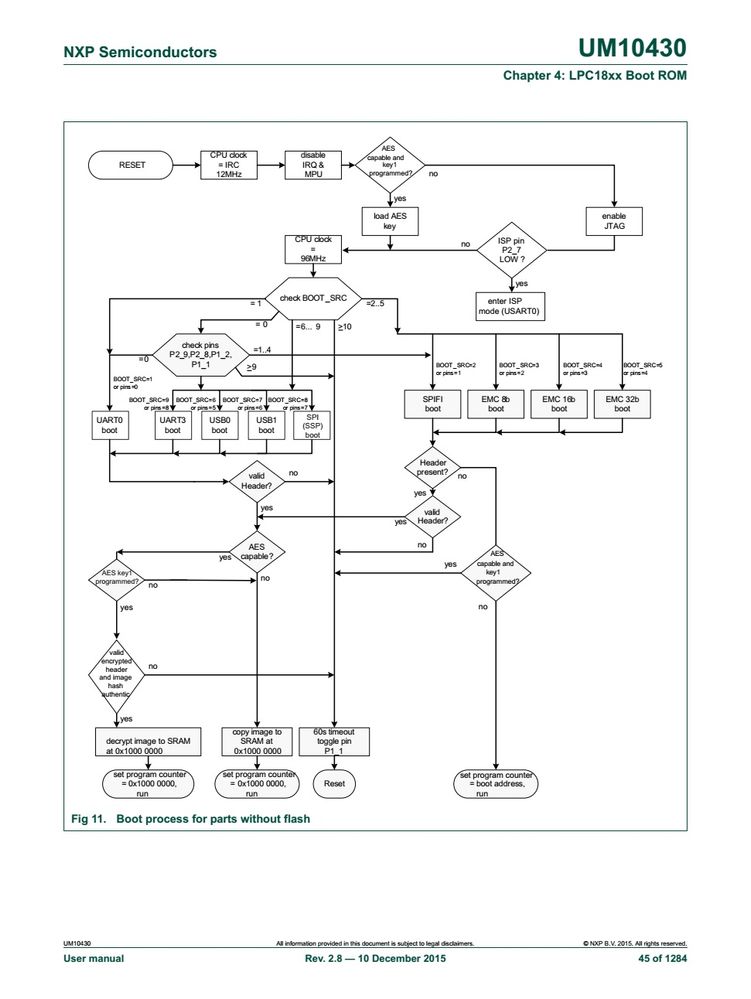

Jeremy,  I did try what you suggested a few different ways without success and then noted the errata that indicated that what was suggested will not work.  It is precisely what I am doing a Soft Reset.  Besides, in the table suggested, if the ISP is not pulled high the soft boot gets stuck in ISP mode (USART0) (see box below).  With P2-7 pulled high the 2 lines
    *(volatile unsigned int *)0x40043100 = 0x10400000;
    *(volatile unsigned int *)0x40053100 =(1<<0);
work great.  I assure you "NVIC_SystemReset()" does not work even with P2-7 pulled high.  I have tried it multiple times with LPC1850.  What am I misunderstanding?  Is there a workaround?  Am I looking at the wrong bits of figure 11?
Scott

The Fig 11 demonstrates the boot process for parts without flash and according to the Fig 11, BOOT_SRC bits and boot pins both can force MCU to enter related ISP mode.
About generating a software reset, please call NVIC_SystemReset() instead of
    *(volatile unsigned int *)0x40043100 = 0x10400000; //memmap with boot ROM address
    *(volatile unsigned int *)0x40053100 =(1<<0); // Core reset
Hope it helps.
