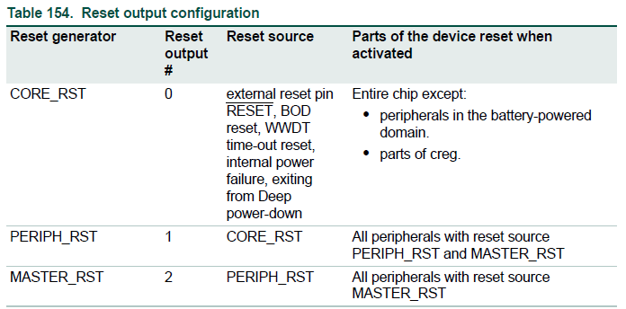

I reset LPC1830 with RESET_CTRL0 register, I use CORE_RST or MASTER_RST to reset.
But sometimes LPC1830 will hang up after Reset.
Before I reset LPC1830, I will reset another IC by I2C interface.
It's hard to debug why LPC1830 hang up after reset, but I did some experiment.
If I add some delay before LPC1830 SW reset. It will not hang up.
Or I use __DSB() before LPC1830 SW reset. I will not hang up.
It seems that LPC1830 is unstable before reset if I didn't call __DSB() or add some delay.
I search some forum "NVIC_SystemReset(void" is suggest method, but it will cause LPC1830 hang up.
Does the __DSB() be suggested function before SW reset?

Hi Ken Su,
for the opportunity to serve you.
I was wondering if you can introduce the testing process in details and the probability percent of hang-up after reset during the testing.
Whether you can share the demo code, as I want to replicate the phenomenon on my site.
I'm looking forward to your reply.
