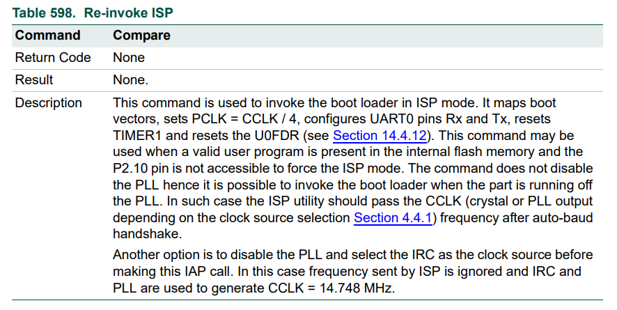

What I mean with the routine that I send you is that you should disable the PLL and run using the internal oscillator before calling the IAP_Reinvoke command.
As far as I see in your configuration your using the PLL feed by the external oscillator to run your application so try to change it to using the IRC with the PLL disabled.

In the user manual from the LPC17xx it mentions the next about the IAP_Reinvoke:
So before you call the Reinvoke command you need to change the System Clock, if you're using the LPCOpen you could try the following routine to call the IAP_reinvoke:
