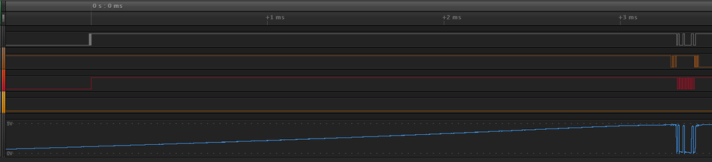

Thank you for your response. I have been performing some more tests and I think I have found the reason for the misbehaving I2C peripheral. Shortly before the test message was send, the board power is initialized. This includes enabling the 5V power supply that is used to pull-up the I2C bus. After adding a 5ms delay between the 5V enable and the transmission on the I2C bus, the peripheral now correctly returns to master pending state (see attached image for 5V enable characteristics).

   The I2C wave really helps to analysis the problem.
   So, your problem still in the power stable area, normally, after power on, before do the detail function, it's better to add some delay, just make sure the power is stable.  If you are using PIO0_22 and PIO0_23 as the 5V tolerance pin, you can use it.
