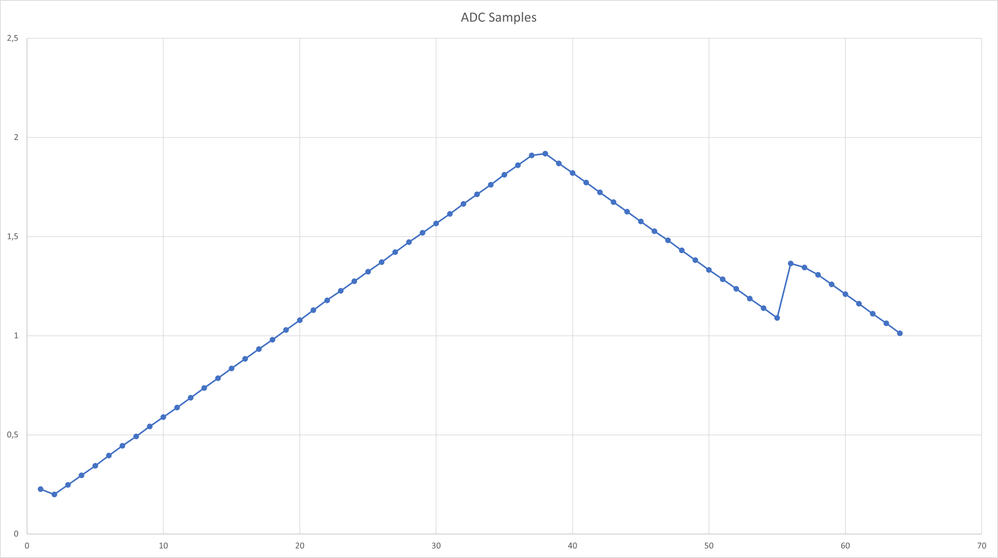

I found this example:
https://community.nxp.com/t5/LPC-Microcontrollers-Knowledge/DMA-Ping-Pong-application/ta-p/1120977
for the LPCXpressor54114 Board and changed it to match the  LPC1549 LPCXpresso™ board.
There are some ADC results in the buffer. But there are zeros and not compleately processed data there too.
I'm using the SCT2_Out3 to ADC0_SEQA to DMA. I'm not sure if the ADC_SEQA is setup correctly.
What could be wrong?
The code is shown below:

Hello Jesper,
“There are some ADC results in the buffer. But there are zeros and not completely processed data there too.”
-> Dose the data all right when only use ADC,without DMA?
Alice

4,873件の閲覧回数
jespermadsen
Hello Alice.
Now the values comes into the buffer.. Thanks.
I removed the boardlib and made some small changes:

There are still some problems in the program.
I tried to set it up with
DMA_TRANSFER_SIZE 64
SCT_PWM_RATE 5000
And a 70 Hz triangle signal on the ADC-input.
The samples with DMA are chopped as you see in the pictures
The samples without DMA has only one jump.
How can this be?
PS: The curves in the figurs are not in fase.
ADC-input:
Samples without DMA:
Samples with DMA:
