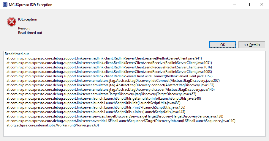

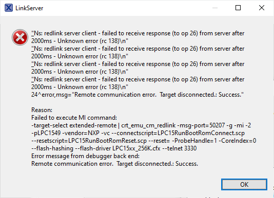

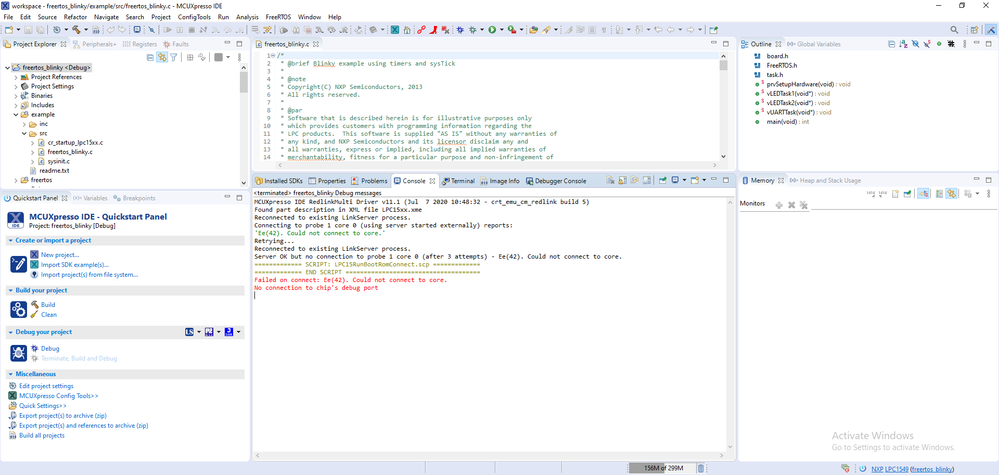

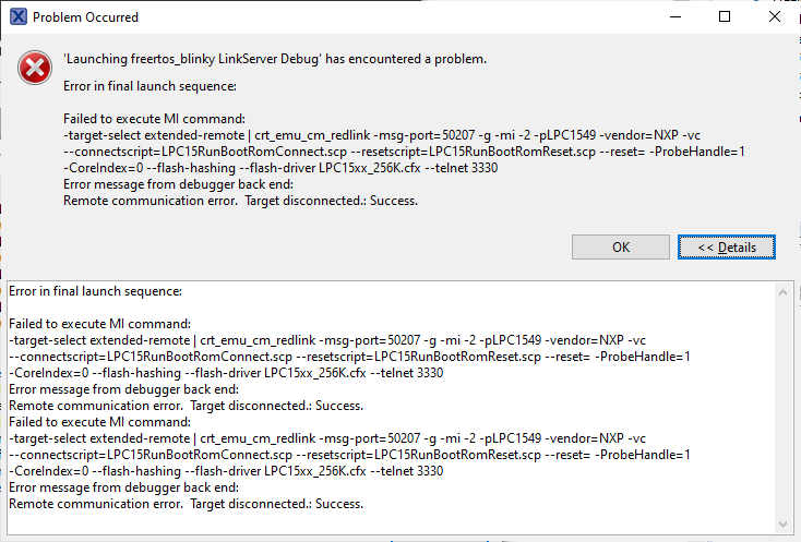

This is my first project with an NXP platform, but I've used Eclipse IDE in the past.  I downloaded and installed the MCUXpresso IDE and imported the LPC1549 sample projects.  I made sure that the freetos_blinky project was selected, then used the Quickstart Panel to clean and build the project.  The images below show my MCUXpresso IDE version and the project having been built successfully.
Once the project was built, I again used the Quickstart Panel to Debug.  The LinkServer probe was detected.
However, the download fails with the errors shown below.
These screen captures provide Console and Debugger Console outputs:
