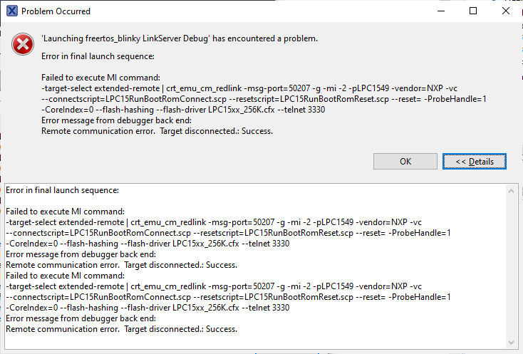

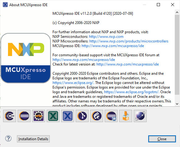

I am running Windows 10 with a fresh install of  MCUXpresso IDE v11.2.0 [Build 1420] [2020-07-09]. I can clean and build the example freetos_blinky project, but I am running into issues debugging it.  I cannot debug my LPCXpresso (LPC1549) V2 Rev C board. The Debug Probe shows up fine as LPC-LINK2 CMSIS-DAP V5.361 with no driver errors.
My issue seems exactly like that found here,
https://community.nxp.com/message/1097643
however the configuration changes in the solution are not available in my version of the MCUXpresso IDE.
I've struggled to find a solution online.  Help would be much appreciated.

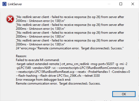

eric_lockman
alicewang, thank you for your quick response.

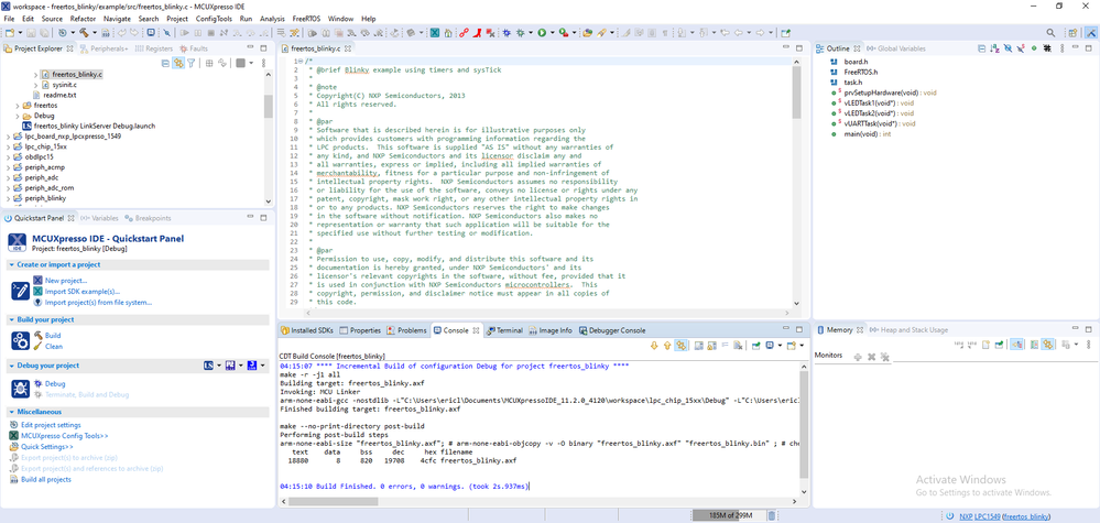

This is my first project with an NXP platform, but I've used Eclipse IDE in the past.  I downloaded and installed the MCUXpresso IDE and imported the LPC1549 sample projects.  I made sure that the freetos_blinky project was selected, then used the Quickstart Panel to clean and build the project.  The images below show my MCUXpresso IDE version and the project having been built successfully.
Once the project was built, I again used the Quickstart Panel to Debug.  The LinkServer probe was detected.
However, the download fails with the errors shown below.
These screen captures provide Console and Debugger Console outputs:

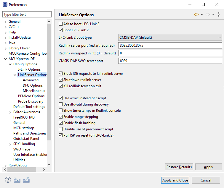

The similar question referenced in the OP suggested disabling the "enhanced peripheral service," however my version does not provide that option in the LinkServer Options page.
I appreciate the help, please let me know if I can provide more feedback.
