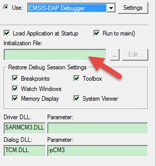

I could not find a Dbg_MTB in the NXP or my project directory nor could I find a dialog as in the photo.
I use the MCUXpresso IDE v10.1.1_606 IDE and just need to remove the MTB stuff if possible from my release (not debug) link script so that I can use the ram interrupt vector which I understand start a 0x0 in the ram.

jeremyzhou
Hi  David Kaplan,
the opportunity to serve you.
You can remove the Dbg_MTB.ini to disable the MTB trace feature.
Fig 1
Hope it helps.
