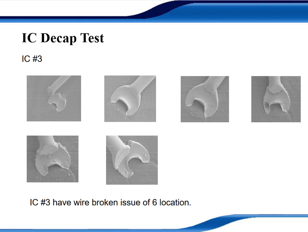

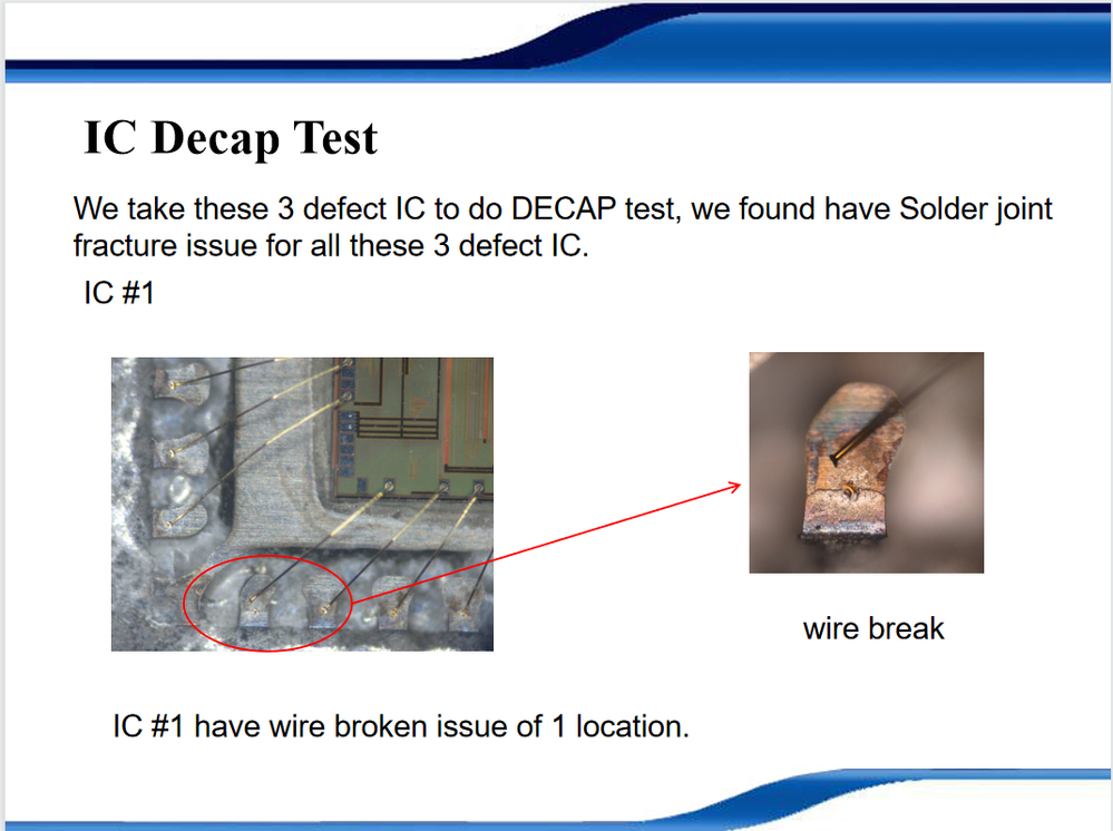

After the lpc11u35fhi33 / 501 chip was put on the machine, a drop test was conducted. It was found that 2% of the products had poor functions and the wafer binding wire inside the chip was broken. Are there any requirements and restrictions for the drop test of this chip? Is the break of the internal wafer binding wire related to the drop test?

Regarding your question that "2% of the products had poor functions and the wafer binding wire inside the chip was broken", can you clarify the test you have done? do you populate the chip on board, power up, test the expected function, but the chip runs abnormally?
How do you know the wafer binding wire inside the chip was broken? does you have a failure analysis?

The chip runs abnormally, and then the X-ray inspection and the cover opening inspection find that the internal binding wire of the chip is broken.  Please help to find out the cause of the internal binding wire of the chip. We will further check it. Thank you.
