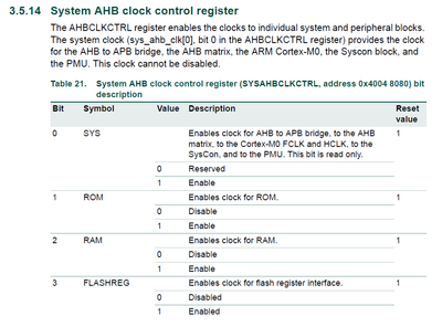

xiangjun_rong
Yes, you have to enable the gated clock of the peripheral by setting the corresponding bit in SYSAHBCLKCTRL before you write any register of the peripheral. pls refer to UM10398.pdf.
This is the code in SDK to enable gated clock of IOCON.
CLOCK_EnableClock(kCLOCK_Iocon);
Hope it can help you
