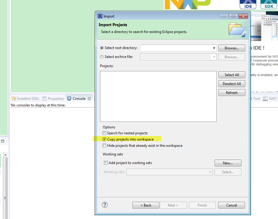

   Please note, when you use the MCUXPresso IDE to import the LPCXpresso IDE, please copy the project to the workspace.
  Just like this:
Wish it helps you!
