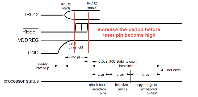

For our product we would like to use the SPIFI flash memory Macronix MX25L25635F in our design as second source.
The manual UM10430 reads on page 49 "A reset delay is needed on the LPC18xx to allow this memory time to come up before booting."
How can I maintain such a reset delay by software?
The implemented bootloader and application are using NXP's SPIFI rom api which sufficiently works with SPANSION type flash S25FL2566S.
During my investigations I experienced the following behaviour:
- loading bootloader and application binaries into flash with LPCScrypt v2.0 does work
- starting the application afterwards fails with spifi_init()
- resetting the target with the debugger will start the application
- after such a debugger reset every successive reboot starts the application again without delay or spifi_init failure even after power down
Does somebody have experiences with a similar setup and behaviour?

jeremyzhou
Hi Mathias Monse,
1) How can I maintain such a reset delay by software?
--These devices take a longer time to be ready after power on. You may need to delay the startup of LPC18xx. One way to achieve this sequence is to delay
RESETN signal of LPC18xx. It needs to adjust the RC circuit of reset pin.
2) Does somebody have experiences with a similar setup and behavior?
-- I'd like to know the more information about this phenomenon, so whether you like to share the code.
TIC

jeremyzhou
Hi Mathias Monse
According to the introduction of the issue, I get that the SPIFI initialization usually fails when first execute the  spifi_init() after entering the debugging, however, it will succeed after recall the spifi_init(), is it?
If yes, I think it's not a software issue, it obviously relates the hardware circuit, as I pointed out that the device takes a bit longer time to be ready after power on.
TIC
