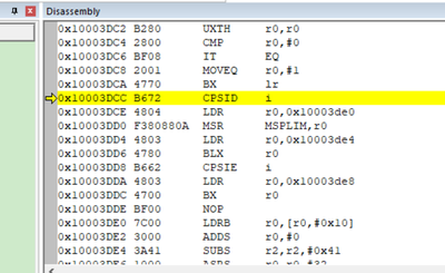

Dear NXP engineers,
      Is the assembly code in the figure below located in boot ROM?
      It means that Core0 boot address is 0x10003DCC when reset in secure boot? And we can't modify it directly when develop the secure boot ?
      We use the LPC55s69 Development Board. Can you share the C source code in boot ROM? I think this is very helpful for us to understand secure boot.

Your screenshot is program flash.

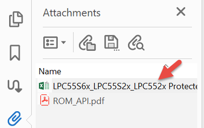

For the boot rom address and description, please see AN11126 attachment. It resides at the end of flash region

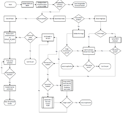

I would suggest you refer https://www.nxp.com/docs/en/application-note/AN12283.pdf
Page2, Figure 1. LPC55S6x/LPC55S2x/LPC552x boot flow chart for 1B. You will be more clear about LPC55s69 boot process after read it.
